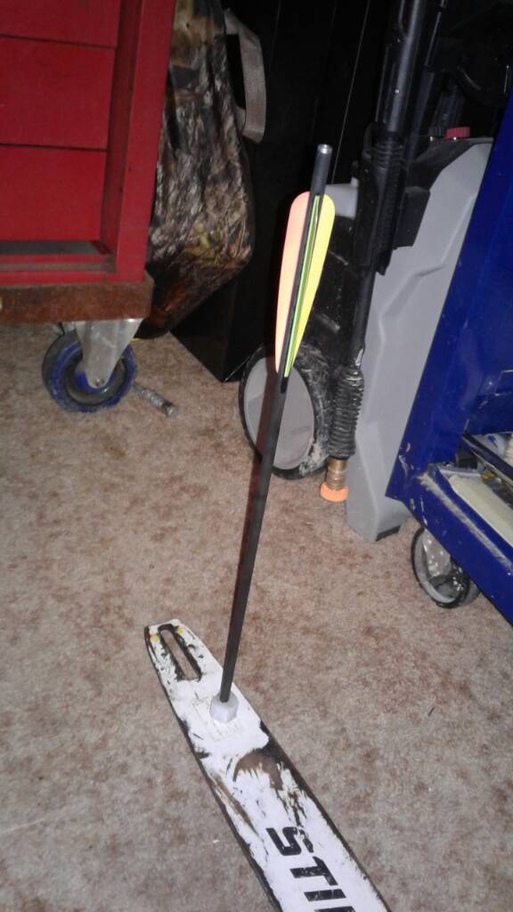

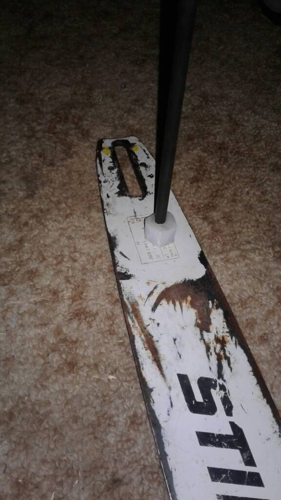

Ok heres what i came up with so far.
I have some of those rare earth magnets so i took a peace of plastic and drilled it out to fit the magnet then epoxied it in. Then drilled hole in other side to fit arrow then epoxied arow in.
Not sure yet what to do for making it extendable. Was thinking i could mabe find tube of some sort to slide inside arrow or take another old arrow and put incert in and connevt with a threaded bolt after cutting bolt head off.
Open to other ideas if yas got any.
Once epoxy dries i will shape the plastic so its more round and probly paint it orange so it visible if i set it down in bush.
That was fast!!!
I am interested to hear how well the epoxy holds the magnet and the plastic. It is common to use a metal cup around the rare earth magnet (it focuses the holding power), then attach (whatever) to the metal cup. Since you can weld, you could weld a sleeve to the cup that would hold the arrow shaft.
As far as adjustability, the Accu-Stick is really precision made, with the telescoping feature. You might want to just use the piece of tape, as described for the Woodworker's Helper, and keep things simple.
