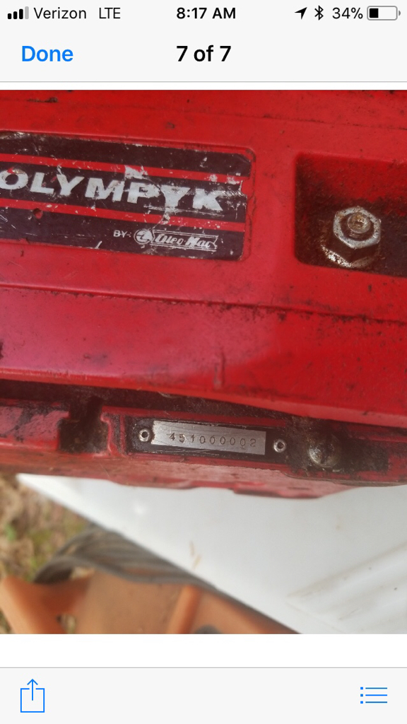

Guys I need help identifying an Olympyk chainsaw. Where can I tell someone on the phone to look for a tag or label or something??? I’m trying to get pictures right now. He has described a 999 but I want to make sure before I buy it.
crackerbuilt
6:46 AM
5572
Mar 11, 2018
111
295
Georgia
Got em!!

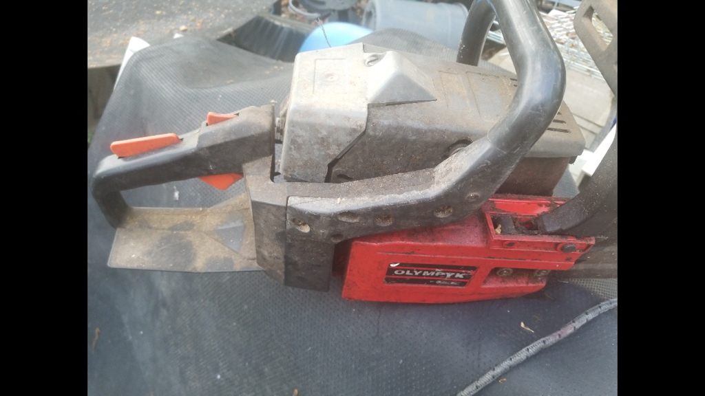

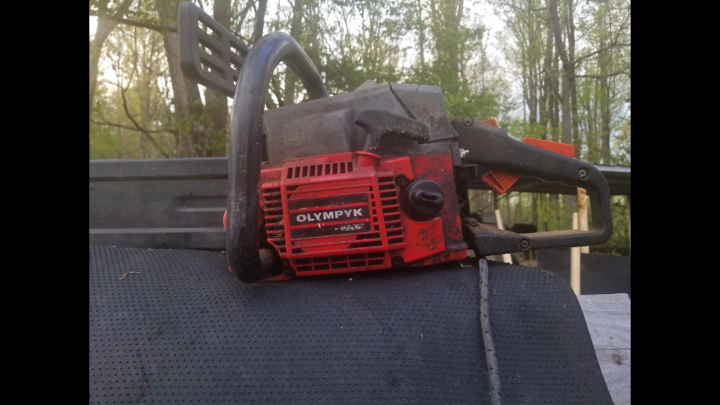

Better pics after picking up and going through. Not much use on the 57
