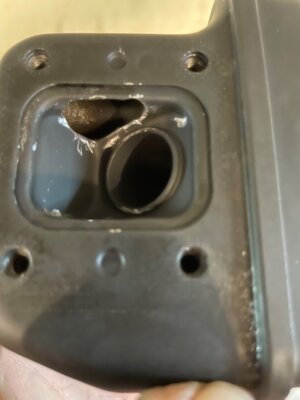

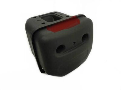

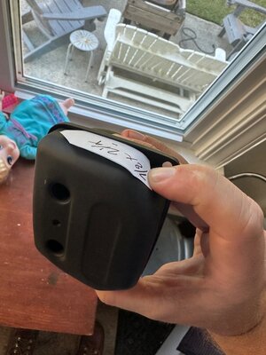

Getting ready to re-do my 590 muffler. My first one was cool at first, but I cannot take the sound anymore. It’s poppy, and just too much. Going to keep the top deflector mod that everyone does but change up the openings
Which of these three offers the best performance without terrible acoustics
Option 1 is adding openings to the side walls similar to the below photo I found in another thread
Option 2, west coast power port 7/8 size. On the clutch side, similar to another members photo
Option 3, west coast power port 7/8 size on top, where I have colored in red

I have only done option 1 on those saws. The other option is to start with a 620 muffler; they have a much more open inner baffle and flow much better stock.

Option 1 is free, the other two will cost either $45 if I go west coast 7/8 route. Or go with a @Red97 cut it yourself and figure my own attachment.
Already have $65 in the muffler, hard to stomach another $45. I just need the flow without the poppy sound

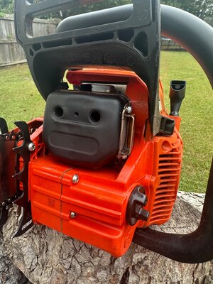

Getting the 590 dialed in. Dukes chain, sharpened a little too aggressive from what I have read. Timing advance, MM, carb nozzle fixed, gearhead air filter seal
Feels like I’m hitting the limiter , still training my ear. Mid 1200 with the cheap Amazon tach

Youre not anywhere near the rev limiter. Too much ignition timing. I can hear it in the cut, cackling. If it's one of those goofy gear head offset keys, take it out and use your original flywheel key. With a pair of calipers, only remove .015 off the key.
Make sure the gas is fresh stuff, 90 octane or better mixed at 32:1.

It is the gearhead key, going to have to track down the original. I was more so trying to get the high setting correct.

If you’re looking for top performance, the OG cs-600p had the farthest advancing coil of any saw in that chassis. There is no exact rev limiter on your saw’s coil—it simply retards the timing drastically past a certain point.

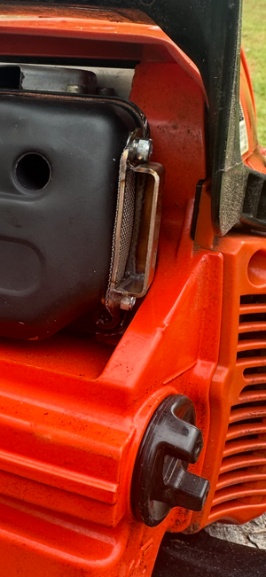

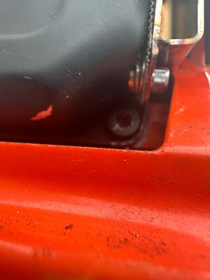

Sound is so much better however I did a *s-word job with the second nut. There is a little gap where it distorted the muffler trying to tighten it up. It’s wedged in there pretty tight however I fear there is some heat escaping the distorted hole
Also concerned about the clearance between deflector and case. Might be stuck with the loud muffler.
It’s a shame because the sound is so much more appealing.
