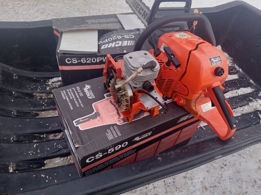

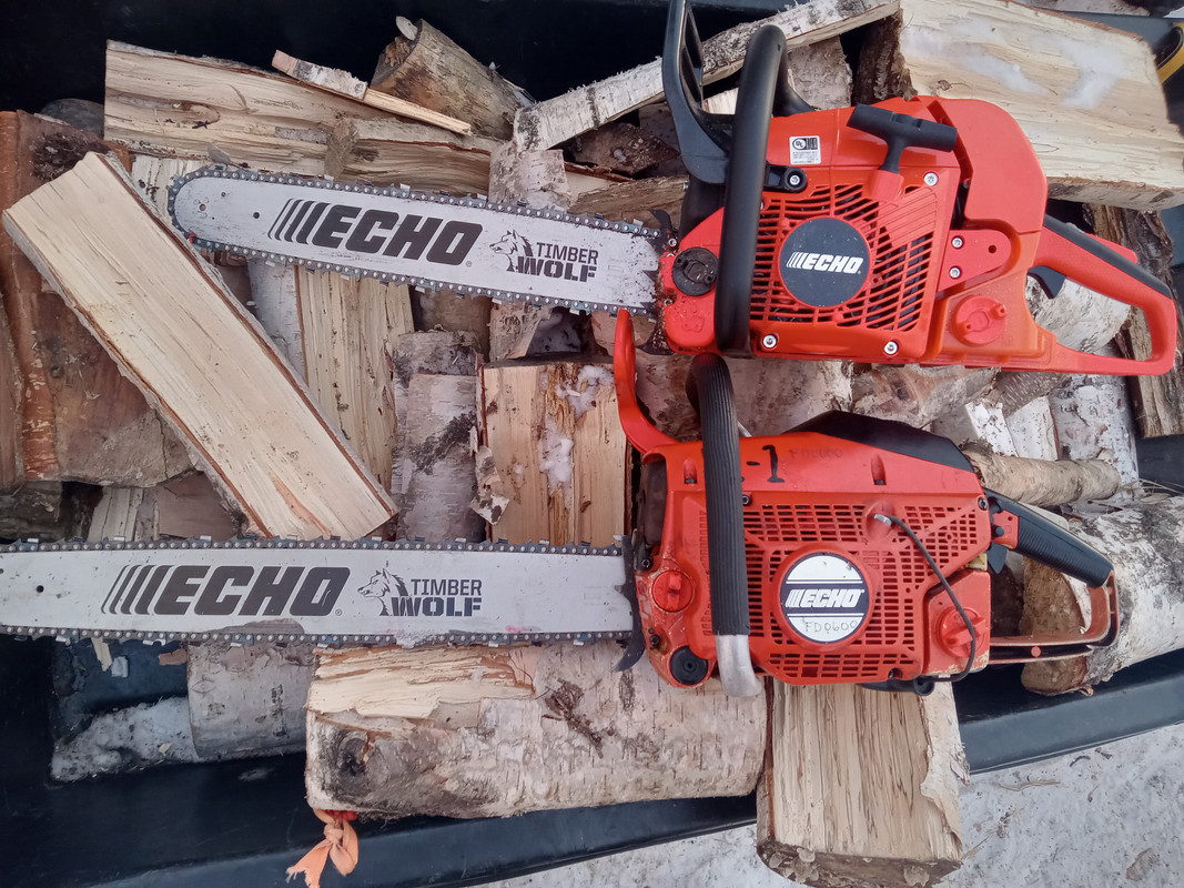

Just about got this torched qv 6700 overhauled.
New impulse, carb boot, bearings, seals, piston, cylinder.
Carb rebuilt, ignition advanced, muffler opened up, base gasket delete. Plastic oiler gear upgraded to brass, case halves and base sealed up with echo 1207d sealant.
Anyhow, this 6700 still comes in $130 cheaper than a new 590. I'm going to compare the two. Which pro-grade budget saw will cut quicker? Does a newer 60 cc equal older 67 cc?
How will these compare to a stihl ms 362? The ms 362 was more expensive than both the 590 and the 6700 combined.
Any predictions?

Round 1 goes to the 590 timberwolf. With the increased compression, the 6700's clapped out starter recoil finally let loose. Snapped pawl off the flywheel when it grenaded. Flywheel fins are OK.
Haha, old saws, didnt even make it to the starting line! Waiting on a fresh recoil and set of pawls.
