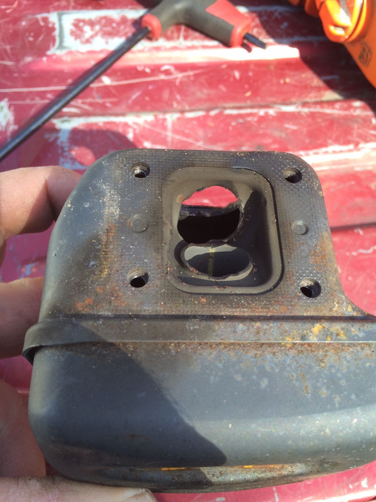

In case it's not known, that tube in the muffler is welded at the bottom and the top. It's not a matter of cutting around the tube at the top, and just sliding the tube out. At the bottom, the tube is welded to a baffle plate. That plate has holes in it that let the exhaust pass through, into another chamber, then out the tube.

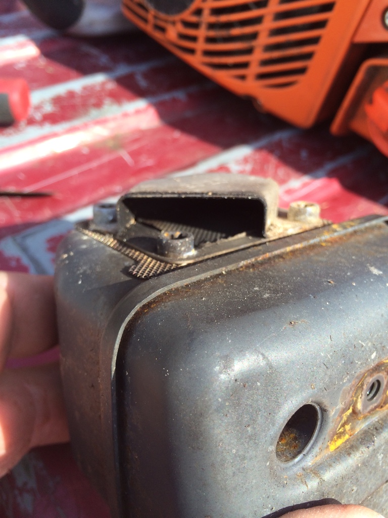

As promised, my muff mod on my 600p
Just cut down the front deflector to open it up.
Just drilled a hole next to the existing hole, and still under the spark screen since all my cutting is done in the national forest.
