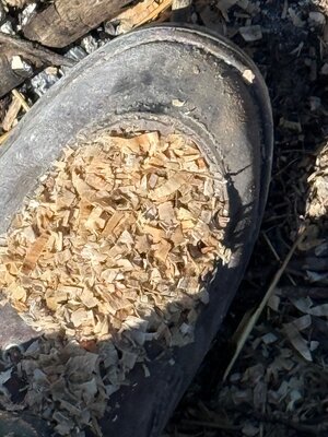

My latest sharpening effort. I go at it with 1/4 then a few strokes of a Pferd 2-1. Is there a way to restore that little beak on the stock grind?
About the only way I could think to do that is to take a new chain and profile a pink wheel to it for a grinder. Only other possible way to kind of do by hand is maybe a smaller round file to just cut the top of the tooth slightly.
