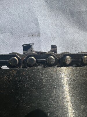

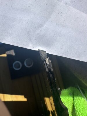

My latest sharpening effort. I go at it with 1/4 then a few strokes of a Pferd 2-1. Is there a way to restore that little beak on the stock grind?
About the only way I could think to do that is to take a new chain and profile a pink wheel to it for a grinder. Only other possible way to kind of do by hand is maybe a smaller round file to just cut the top of the tooth slightly.

I've mentioned this before...
- The "original" orange label chain is a copy of the Husqvarna xcut with the pronounced lip at the top. Very aggressive and great cutting chain out of the box.
- The "blue" label is a copy of the stihl RS chain. Less aggressive out of the box.
The Duke says the metal is the same for both chains. I much prefer the orange label chain for it's aggressiveness. But, once that lip has been filed away the chains become the same.

If you don't keep a grinder wheel dressed to a radius.
After a while, the top plate of the cutter will wear back the area of the wheel that hits the top plate.
There's a lot longer grinding path in contact with metal where the top plate touches the wheel.
Think about it from side to side, not in how thick the plate is from top to bottom.
You'll actually begin to get a tooth that resembles that undercut look on the top plate, if you let the wheel go undressed.
Grab some rock damaged chains and rough grind them in, but don't dress the grinding wheel.
Don't dress up the rock yet...Now grab a chain that just needs a little touch up and grind a couple of teeth.
You might be surprised at what it's starting to resemble.
You'll be better off with a single point/diamond tool to try and create that profile on the grinding wheel though.

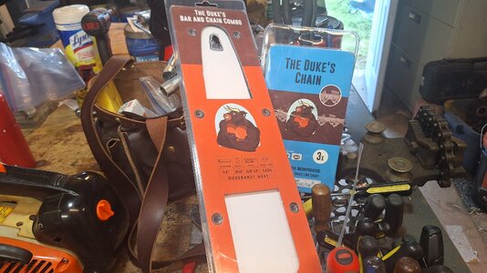

I’m a little confused too. The blue label page options are 3/8 72 or 84DL in 50 or 63.
The orange label page has a plethora of options, so that’s where I found my choice.
Chain is fantastic in quality and price and I absolutely could not be happier with my purchase. The confusion for me is the blue packaging.5925A238-8816-41D7-9BA1-EE0B3767F90D.jpegC7037C24-9125-4299-8E59-AC490979381E.jpeg
I should add that a previous order of .325 came in the orange package. Of course as they say in Pee A, this is certainly “small potatoes” meaning of little consequence 😎
