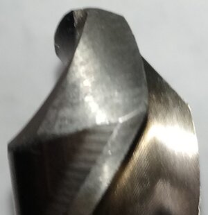

High quality drill bit, but quite shatter prone and the cutting edges dull a bit faster compared to the aforementioned bit, Solid-Carbide

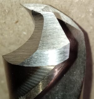

HSS-Co drill bit freehand ground by me, 12.0mm OD so it doesn't quite fit within the "UNO" camera view field.
Wheel wasn't too good missing a sharp corner, hence the resulting mediocre "cross cut".
Was intended to be a spot drill, as such the cutting edges are ground at a steeper angle (~90°) and the relief is quite extreme.
I liked the result I got, but in the end it didn't get used as the workpiece proved to be too big for the mill.

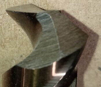

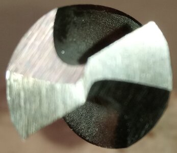

High quality drill bit, very durable and well contoured cutting edges, Solid-Carbide
View attachment 373504 View attachment 373505 View attachment 373506 View attachment 373507 View attachment 373508
I never used this brand... but, I have and continually use Guhrings. My drills and taps last a Very long time and I basically cut everything. From zinc, copper, various aluminums, plain carbons to high carbon, various tool steels, various grades of SS, once in a while inconel as well as various grades of Titanium.
Like anything... Speeds, Feeds/chiploads and rigidity... they all dictate how long bits/cutters last... We all know cutter geometry, the hardness of the bit being used, the ability of the bit to retain the cutting edge when operating at elevated temps as well as wear resistance at those elevated temps are crucial, but they all fall back to speeds, feeds/chiploads and rigidity. If someone spins up their bit and it exceeds the red heat range, it's obviously going to fail... if the setup isn't rigid, it's going to fail, shock loading carbide and/or cobalt, it's going to fail... I have guhring taps and drills that I have been using for a couple years now... I have definitely gotten my money worth out of them? I've had such good results that I don't even entertain the idea of swapping brands, changing geometry etc... I am budgeted "x" amount for expendable tooling... soooo needless to say, my box is filling up with Guhrings. 🤣😅
