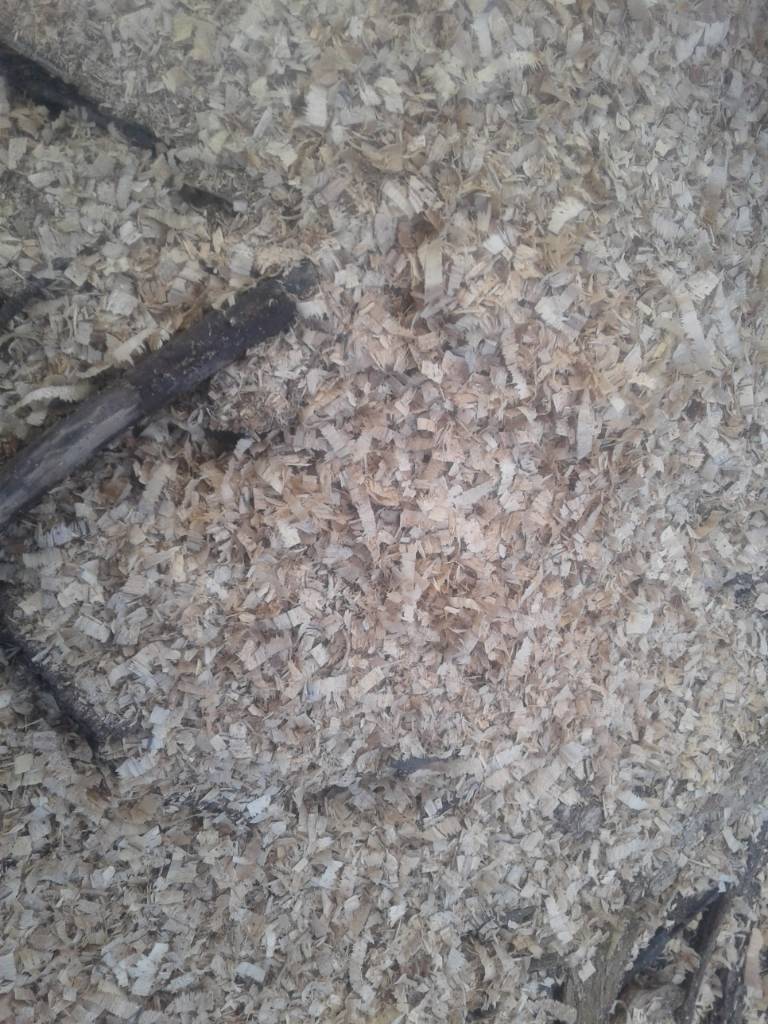

Well i figured i would try to sharpen that barracuda chain. I used a small flat file and just tried to keep the same angle. It accually is making chios now vs the powder it made befor.
Mabe i will break down and buy a normal chain sometime but this works for now.
Gonna use this little saw just for marking the fire wood length.
