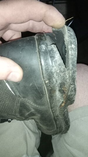

My work & pup long walk boot(s) gave up today.
Looks to me like a "programmed failure point"!
I have no spares yet.
That's a cup sole. Break out the super glue for one last go.

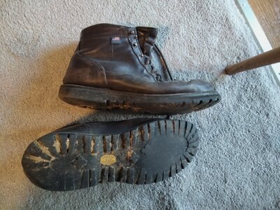

Again, not sure what model they are, but here is a couple of pics:
That's just like the Acadia with stitch down construction and a foam midsole and the Vibram 148 outer sole. If you have a belt sander that's an easy fix.

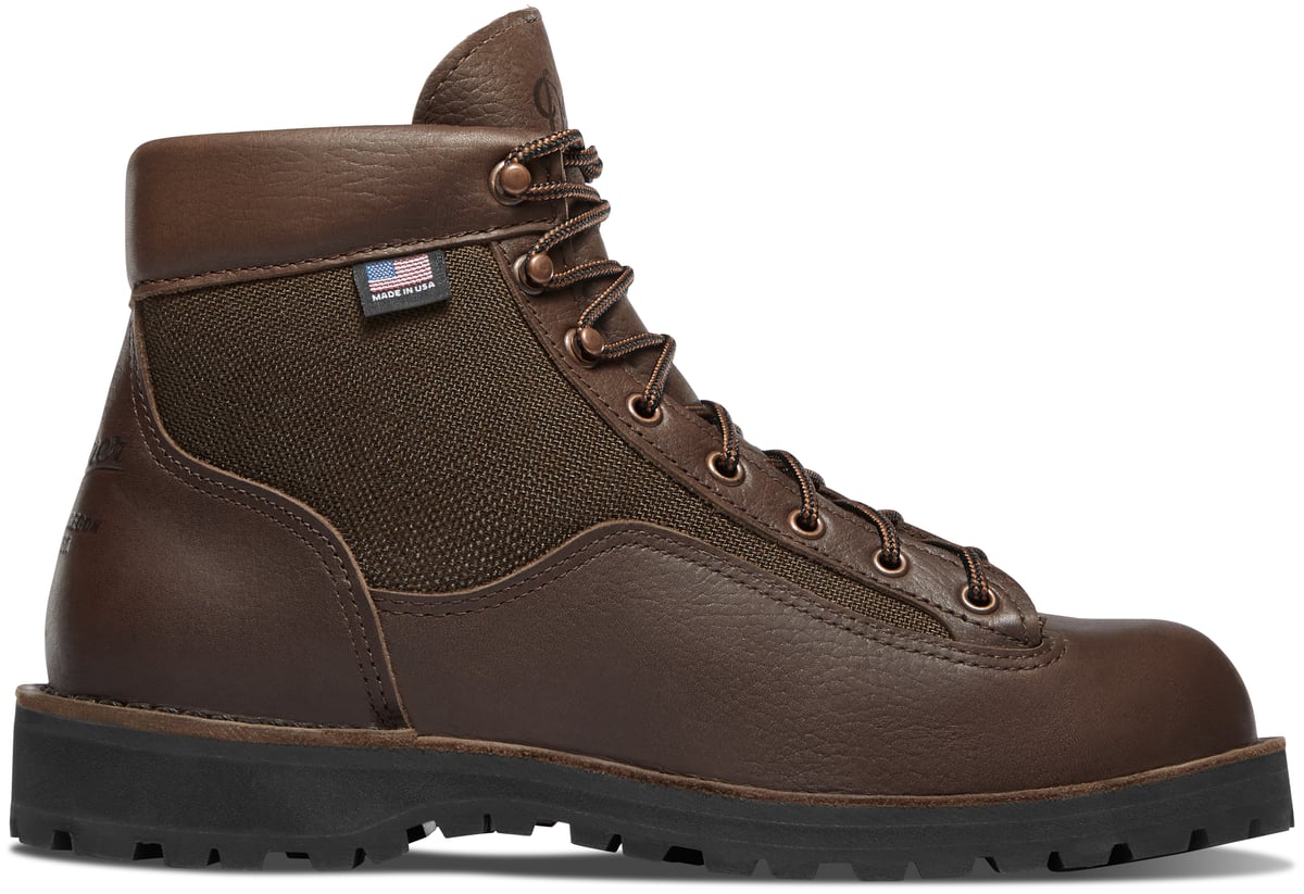

Looks like those could be a Danner light 2 or explorer.
https://www.danner.com/men/all-footwear/explorer-6-brown.html

Yup, that looks like it! No belt sander handy, so just basically sand off the old sole and glue on a new one (the one you linked above)?
I trimmed the lugs flat as I could first before sanding.
I used this kit to sand with.
And it's not the prettiest sanding but it's held up.

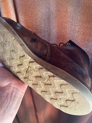

1907 yeah. I had 2 soles put on the last pair and the leather was still good but just got worn wonky to the point it was time for a new pair. My favorite 3 season boots. Sum *b-wordes cold in the winter.

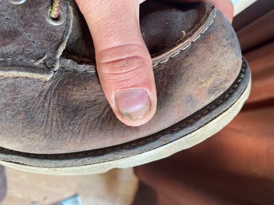

Some RW heritage line boots have had problems with the gimming coming loose and that's probably why the started wearing funny. And I haven't messed with speed hooks but check this out around the 15:30 mark Steve installs the speed hooks through the eyelets using them a washer of sorts. Of course he's using a fancy press thing but I think one good make a die out of a peice of hard wood or steel and hammer them on. I'd probably find some thin leather to make a kiltie so they don't tear up the tongue.
