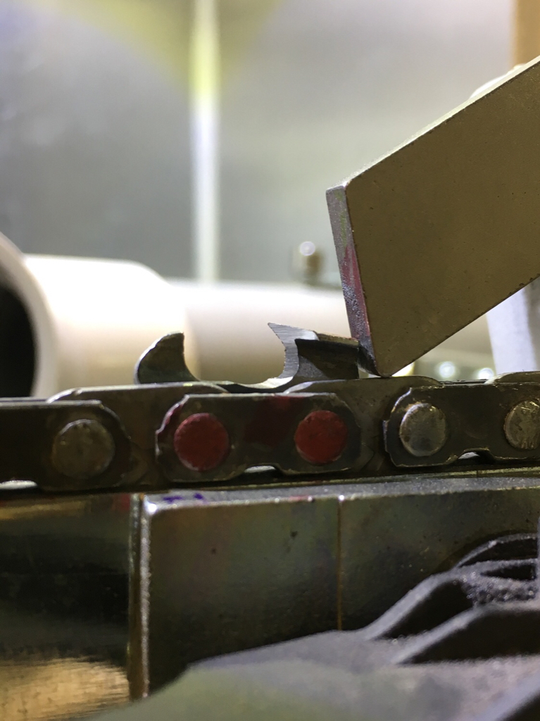

I snapped another pic of the chain so you guys can see the rounded corner of the cutters...it's funny how different picture angles can creat optical illusions...
Oh and as always guys please feel free to critique my chain lol....
What angles are you using for semi? They look great.

I go a degree or 2 more on the hook so when I’m in the field filing with a guide my file only takes from the top 1/3 of the cutter and not the gullet so in short fewer passes to be razor sharp
