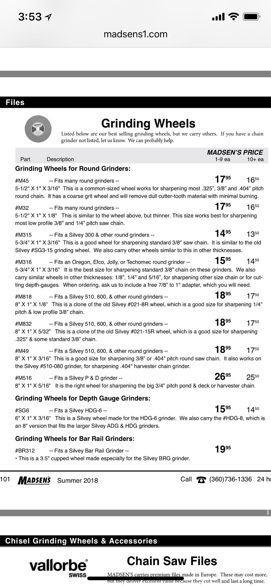

1" to 7/8" ?
Philbert
Or a slice of 1" od tubing 1/16" wall. Course finding it wood be easier if any of my old bosses were still alive. Two of them I was older when they passed. Custom metal fab shop that had some of the oddest material cause the old man wood bid on stuff other businesses passed on.
Skeans1
11:22 PM
6510
Jun 24, 2018
1,735
9,537
Oregon
1" to 7/8" ?
Philbert
Correct
#M316
