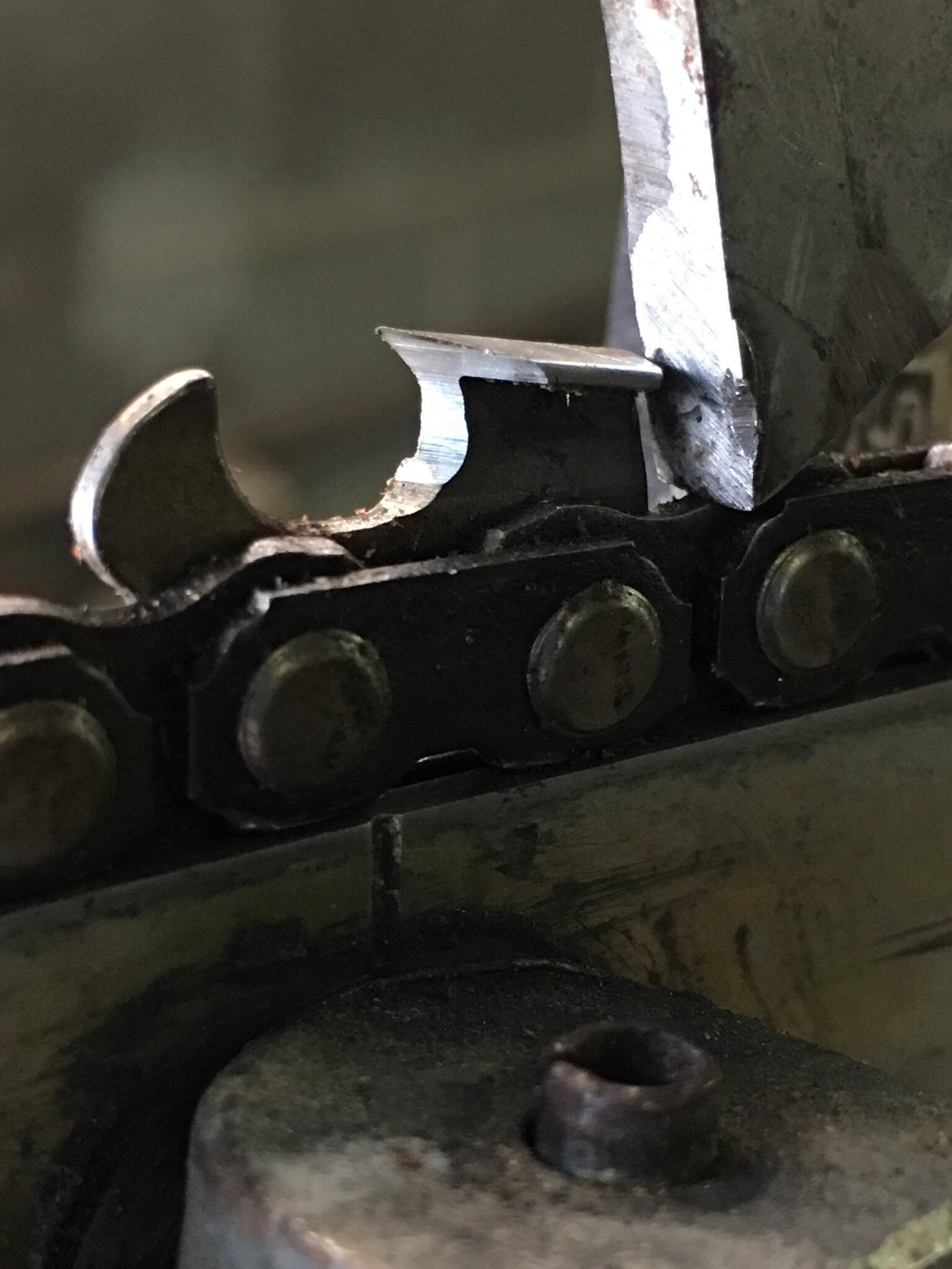

Ok guys, yesterday I got 7-more chains to sharpen,(one customer brought 2-chains, the other customer brought 5-chains).........so after I sharpen about 2-3 more chains, my 1/8 CBN wheel will be paid for with grinding profits!!!!
Any way thought I would share a few pics....also I did these chains with my CBN wheels....
Here is a horrible chain(it's a Carlton chain)
Here is a 3/8s Stihl RS chain.....I ground the teeth, by I haven't hit the rakers on these RS chains yet....I will heck them with my gauge when I get home....these gains are from a 1st time customer, so I want them to be very sharp, but not grabby....

Well guys I have had a few more guys drop off chain to be sharpened....wow some of these chains I get are just absolutely beat to hell.....I feel bad for some of these guys saws, they basically burn the wood.....I just don't understand it.....some of these guys tell me they have cut for years, but when they hand me their chain, it's hard to believe it.....my dad instilled how important a sharp chain was as soon as he thought me to use a saw....when a chain got dull, he said load up, leave, or file that chain.....
Anyway, here are some "glamour" shots of some over worked and under appreciated chain....IMG_2143.JPG IMG_2145.JPG
Here is some finished product

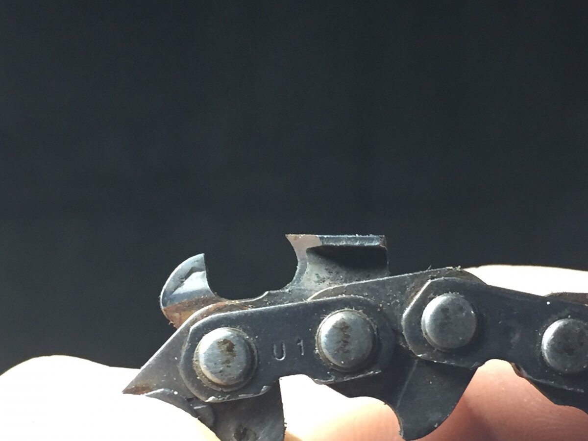

Looking at the chain pics you guys post tells me there is something wrong with mine. Here is a comparison. See how deep my gullet is compared to Khntr85's chain?
cowroy
12:33 AM
1657
Aug 6, 2016
318
1,496
Tennessee
I think my top plate angle is too steep. Pink wheel. Pretty sure I got it from Northern. The chains are just a little too grabby for me.
