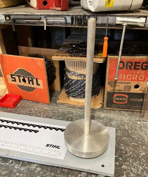

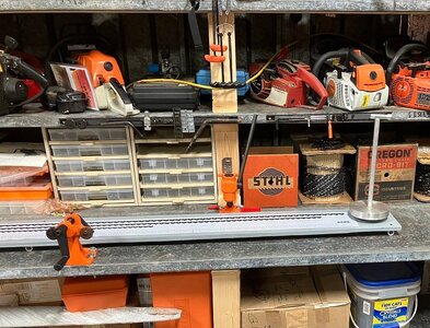

Thought I would share my setup for service on saw chains and sharpening and filing. Maybe help someone with an idea and if there are suggestions for improvement I would love to hear them.
This is where I can make up new chains from a reel or repair or shorten a chain if it makes sense to do so.
I have links, presets, and cutters in the bins, and all the tools for the breaker and spinner are on the magnet bars on the shelf.

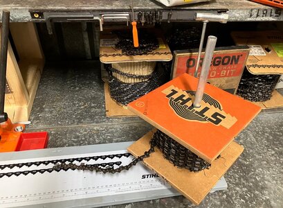

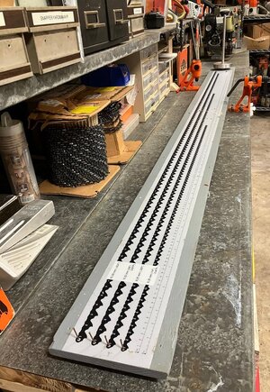

Here is a view from the end. The link chart is on a board so I can move it if the bench space is needed.
There is a spinning platform for the reel.

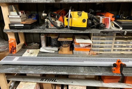

cus_delexe, I have 2 BP1 saws, one is complete with the bar and the sharpen on the saw chain and runs, the other is rough. I am still in the middle of remodeling this building and getting things organized so I can display all the saws so eventually I will post more pics as I get there. I built the sharpening station a couple of years ago so I could at least keep stuff cutting. A little more gets done each day.Library.JPG
This is the wall where the chain service tools are located. I built it 10' high, but I decided to put all my reference books and manuals up top since saws wouldn't be as easy to see and I don't need to get to the paper stuff very often anyway.
