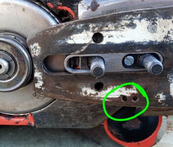

4:59 AM
14,993
59,818
Stihl 12mm mount bar that came with a PS-7900 purchase, note the additional oiler hole drilled.
I did not check whether it was needed or not since I have no intentions of utilizing this bar other than for flat steel stock.
Picture shows the bar fitted onto a PS-7900.
Bar adapter is my creation.
