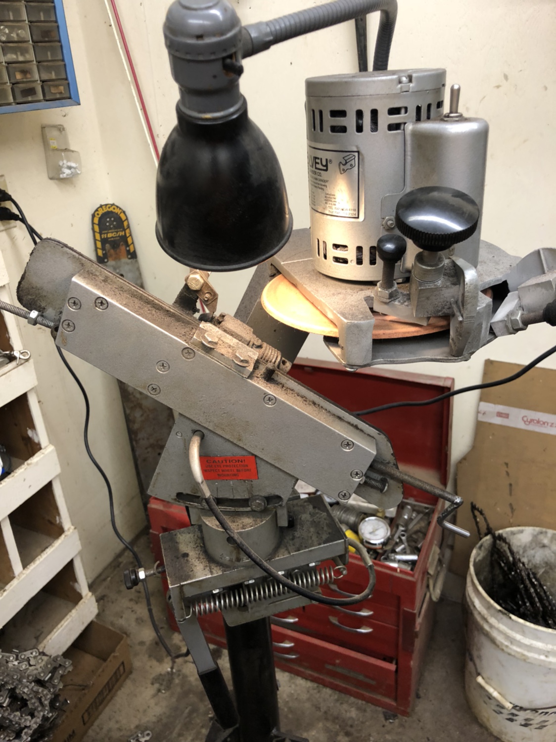

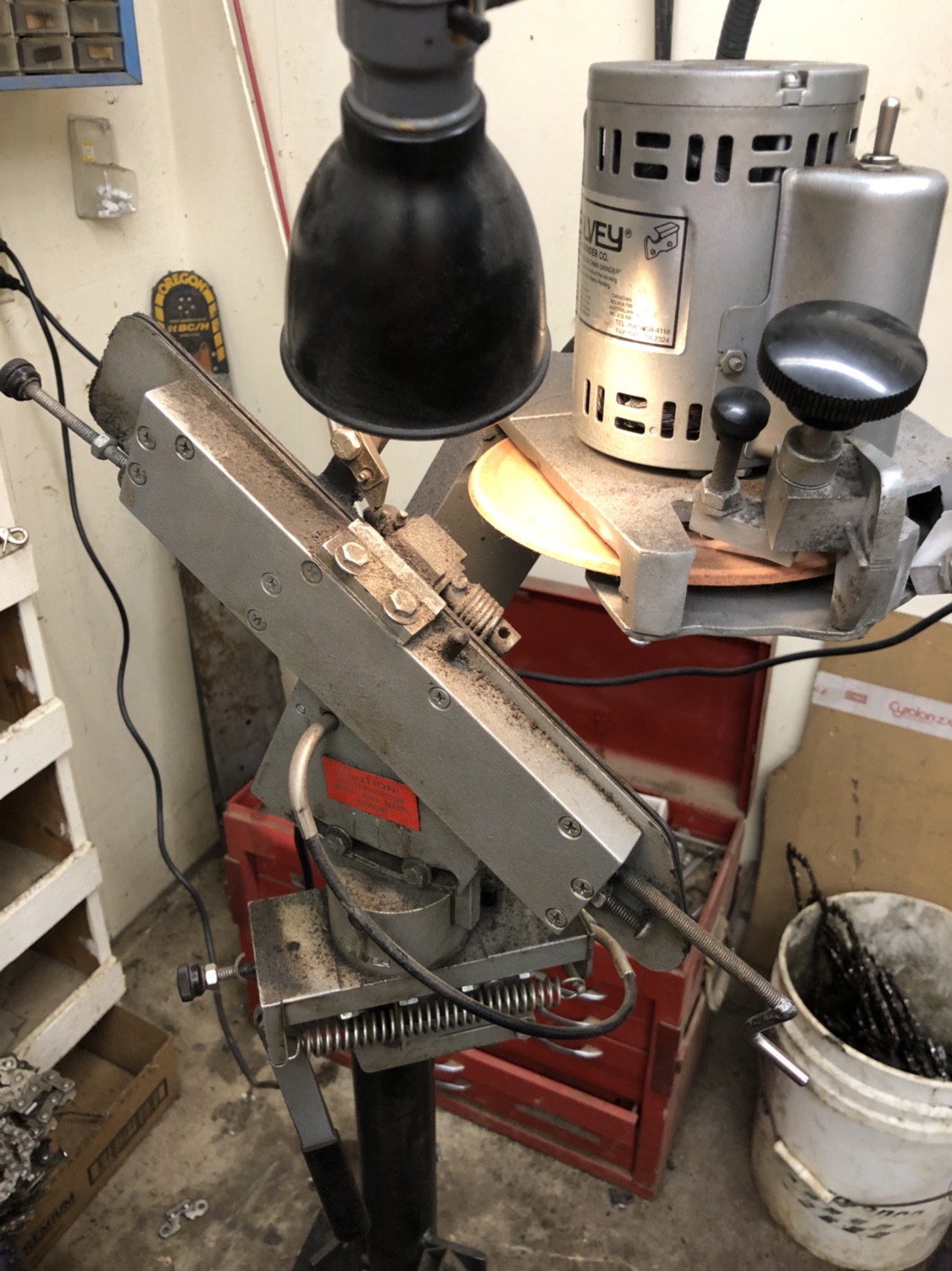

Why would you believe this to be true ?
It’s the only square grinder that the vise actually swings on a center axis vs a swing arm style or the sdm where the vise is a solid mount. I’ll run down to the shop and get you a few pictures.

6793f3f098c44b657f5a965e380005d5.heic
37fd7b82c972e643356bbbea3dfc247c.heic
b7fceff91728a00198d136e5ed115815.heic
b383a4718eb978c56436dda1c553ca00.heic

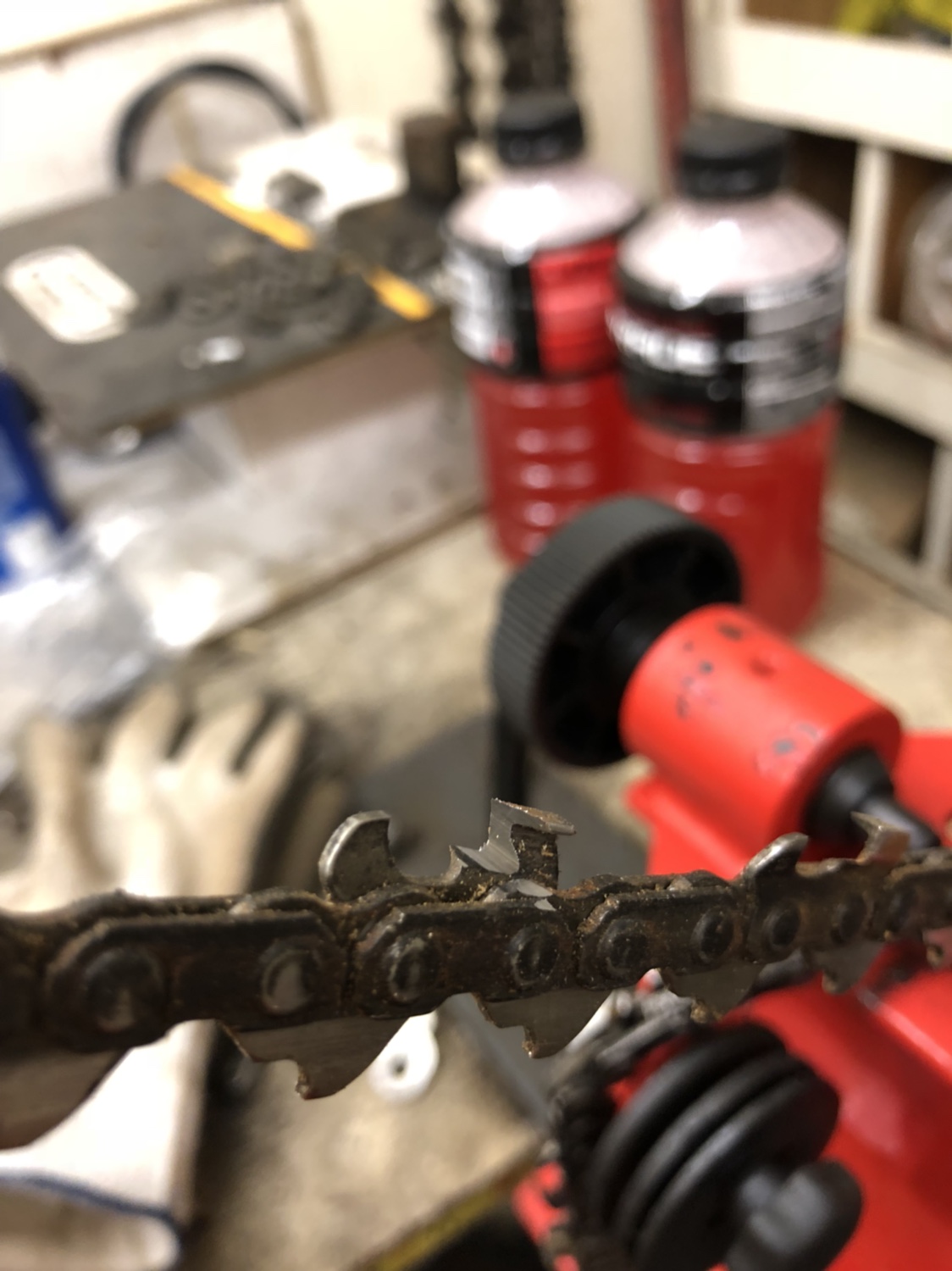

If you are only using a grinder for square chain, does the 'shelf' serve any purpose? Wouldn't the chips clear faster without it?
Thanks.
Philbert
That’s all I cut with is square for hand falling, which shelf? Do you mean the lower slides?
Thanks.
Philbert
That shelf is called a gullet.
You can't grind the gullet without hitting the tie straps, it has to be ground in an additional step. Folks will leave them be for a few grinds just like rakers.
But you can't let them get much longer than 1/8" or they will bind in the kerf.

I call the 'gullet' the area in front of the 'shelf'.

I get how the shelf can help help guide a file, but not how it helps a grinder. It also looks like an obstacle that the chips have to avoid. Looks like it could be removed with a round file or round grinder if not needed.
Just asking . . . .

Normally I do, that was a chain sitting I just grabbed real quick when I grind a chain I’ll dress the wheel back to enlarge the surface which takes the gullet out.

Nice grinder. You have a better pic of your chain? I can't find an intersecting line at all
The wheel is a rougher one it’s hard to see the corner unless it’s up against the wheel or below making a beak. Normally I’ll start with a sight beak then raise the carriage till it’s corner to corner or sightly below.
