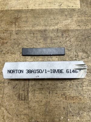

Squareground3691
11:08 AM
16376
May 1, 2021
3,353
16,249
New England
Norton Norbide dressing stick Top pic
Norton Aluminum Oxide dressing stick Bottom pic .
Top stick for verified stone wheels
Bottom for Diamond/ CBM IMG_1368.jpeg
