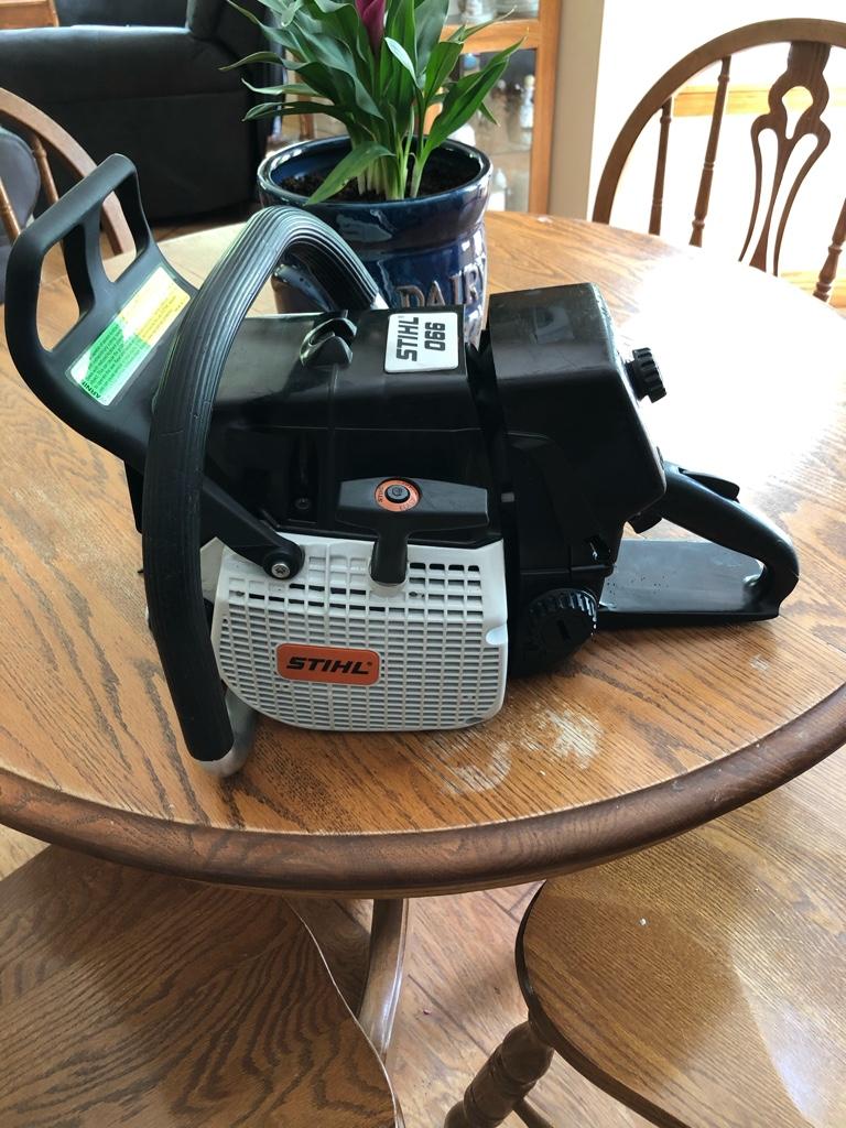

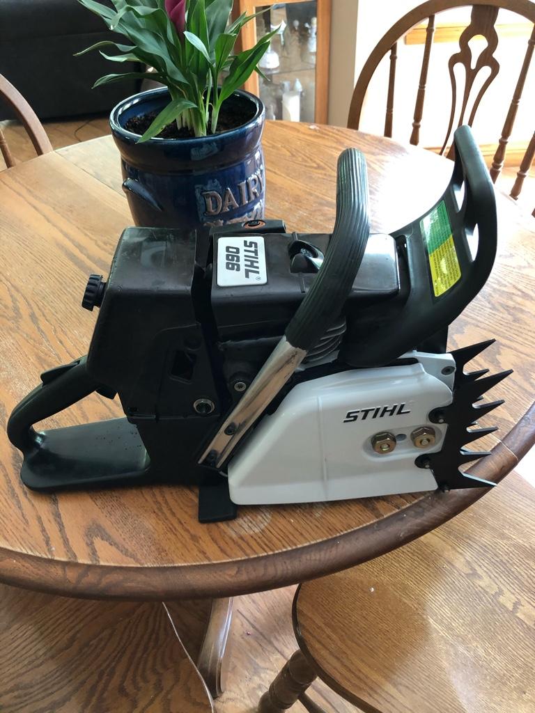

Just finished a short case poly flywheel with heated handles myself. Ran a half a tank & seems to have some bling / my favorite 066 so far
