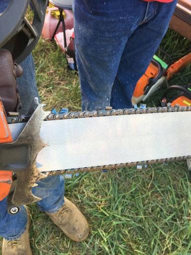

Too funny, Kenny’s getting called out!
I’m not sure I remember hearing of any Lightning performance saws to be honest.
I’ve only seen him with stock saws at GTGs.
With backwards chains....at one time I had the pic to prove it. Poor Kenny...poor poor Kenny. :D
Time's Standing Stihl
Below me...
12:21 PM
1179
Apr 20, 2016
11,249
64,406
Central Iowa
Had to dig a bit, but i found it [emoji41]
