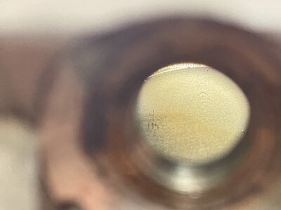

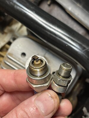

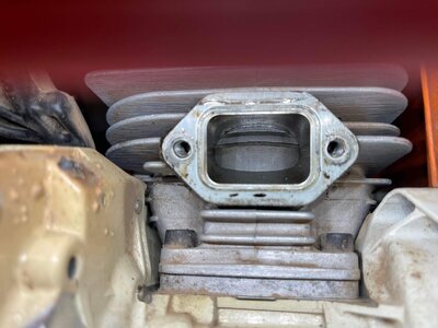

I’ve ran a couple of gallons since the rebuild and wanted to check all the hardware was tight and that there was nothing untoward internally so far. Everything seems good. I could probably take the Amsoil saber from the 40:1 I’m currently at to 32:1 without any issues of spooge, but at 40:1 it’s decent in the hand held trimmers and blowers so it’s a compromise otherwise I’d drop to 32:1.
