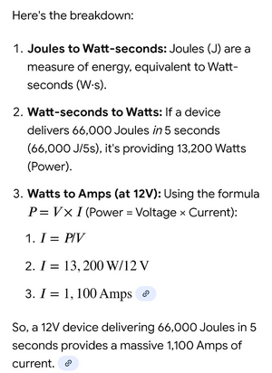

Still, false advertisement even on the spec sheet of the posted link, 66000 Joules/5 seconds at 12 Volts is not the claimed 5000 Amps.
It is 1100 Amps, according to Google AI

Just about every single jump pack made advertises some kind of "peak amps" which are always far more than the power that can be supplied consistently over a meaningful time frame.
If you carefully read all the info related to this specific jump pack there is nothing, absolutely nothing claiming that it delivers 5000 amps. Marketing yes, false marketing no. Deceptive marketing? Sure, but all marketing is deceptive in my opinion. There isn't any info available on what the actual output is, but I do know it will easily start a 7.3L IDI without any batteries installed in the vehicle. The only claim the company seems to make is that it will start gas & diesel engines up to 10 liters. If I had a 10L engine I would go test and make a video.
It is interesting that the company does claim that their largest 12/24 volt model will deliver ". . .over 10,000A of starting power. . ." but none of the other models include that specific language. It's kind of like when Harry Truman gave the okay to drop an atomic bomb the military told him they would be dropping just one bomb of the tested type--but they were also dropping a second bomb of the untested type. The Devil is always in the details.

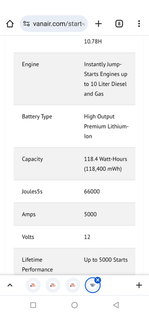

I kinda knew You would counter argue.
Says clearly 5000 Amps on their specification sheet.

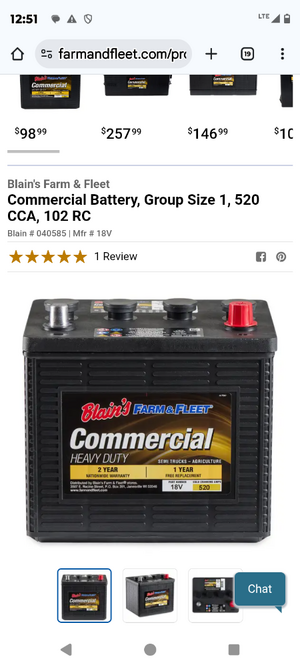

I can't find any battery comparable today for CCA (870) of the same size that will fit inside the battery compartment. I just shopped the same size for my cousin's 1953 Ford NAA, best I could find was 700 CCA.:(:(

Stating 5000A is not a claim to anything--it's just marketing. All I'm arguing is that the only claim the company makes is that the charger will start up to 10L gas & diesel engines. If they claimed 5000A output then that would be a different story. And if you can show me where they make a claim to 5000A output then I will gladly admit I'm wrong, but I haven't seen any such claim.
I would equate their "5000A" labeling as not much different than a company adding "35% more FREE!" to a package of chips or crackers--they're not saying what they are giving you 35% more of. I would say it's a shady practice but it seems to be a common practice. I have no emotional stake in this, but I am interested in the facts.
And I of course checked and double checked their various "spec sheets" and they don't list anything in terms of actual output. I only bought one because the insurance company was paying for it--I would have never paid out of pocket for that "thingamajig". It does work well though, and hasn't failed me yet.

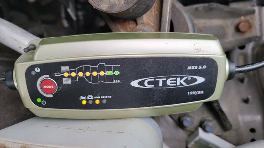

To combat imbalanced cells, partial state of charge, and sulfation, I bought this unit. It suits my needs.
Not saying that mine is any better/worse than all the others.
Keeping the car battery topped off in teen weather.
