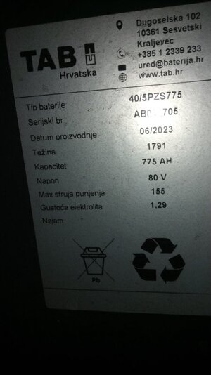

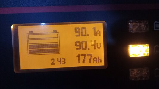

And that is the "slow" charger for this 1800 kg battery.

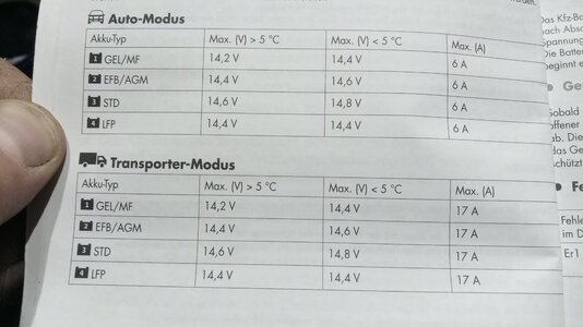

The nouances in charging Voltages between the different battery types is staggering.
Yet they all seem to support the same charging Amperages up to 80% charge.
This is out of the manual of my currently most powerful charger I own, quite recent purchase so I haven't used it other than playing with it's battery & alternator test functions.

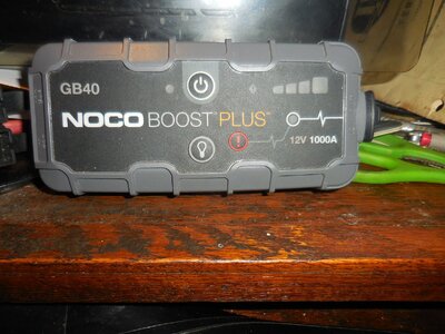

Philbert
I have the same charger pictured here always worked well for me.
Phil187
