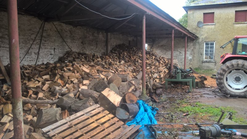

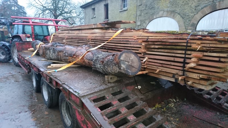

Here's a bunch of filthy wood left over from a flood.
Some of the big stuff gets planked.
Most turns in to fire wood.
And none of our saws are stock:
