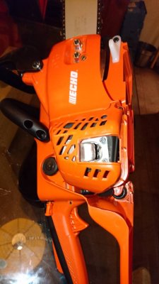

Well, you guys (especially WoodPecker) convinced me to try a version of the 355T muff mod that he documented. I decided to simply use my DP to drill a 3/8" hole in the lower portion of the plate that covers the screen. Then I smoothed out the burrs with a file and some sandpaper, enlarging the hole somewhat, but not much. Here's the result:
The idea, I believe, is to open it up in the area that is not covered by the orange plastic so that the heat will not burn it away. Anyway, this seems to work OK so far. The engine seems to be breathing easier and after the mod, I was able to reduce the idling speed about 15%. A great rainy day project, and that's about all we've seen for the past week with more rain on the way.
BTW, there are three bolts holding that orange plastic cover on and one is hidden by the sprocket/clutch cover that has to be removed before you can work on this plate. The fine-thread bolt helps fasten on the belt clip. Thanks again, WoodPecker.

Nice work! Did yours have a cat? On my muffler you could look right through no restrictions.
No cat that I could see -- unrestricted. This saw is about 5 years old and is an early version, about when the 355T was launched. A climber sold it to me last year when he thought it was getting old. I installed a new carb and it now runs like a top. The spark screen was surprisingly clean.
My only complaint with these is the rather weak belt hook, similar to all the Stihls. The one on my CS-3400 is much stronger. But, the 355T has a better design for the mount on the rear of the handle and better balance. Pssstttt... don't tell anyone that I picked this saw up for $225 delivered. I suppose I could have spent twice that much for a used Stihl 201T. That seemed a bit pointless.

We picked one of these up early October and it'e been awesome. Thanks for documenting this simple muffler mod -- will add to the project list and do it to ours. I like how saw run cooler with opened up mufflers (and of course the performance boost!)
Cheers.

I cut a radius around the bottom and bent it out wide. The exhaust seems to clear the cover and chassis fine.
