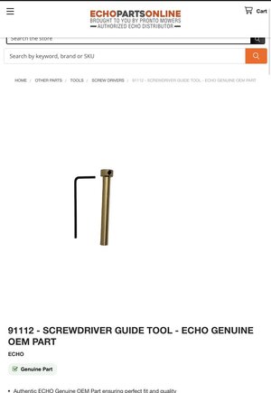

OOOh! Today I pulled 4 off two 2511T carbs and tossed them in the trash. Guess I'll be dumpster diving in the morning.
The needles stay in place just fine with them off, but due to how small the needles are it can be hard to line up a flat screwdriver without looking. Echo sells a sleeve that fits over the screwdriver shaft that centers it on the needle, and you could do the same with a piece of copper tube. IMG_0985.jpeg
