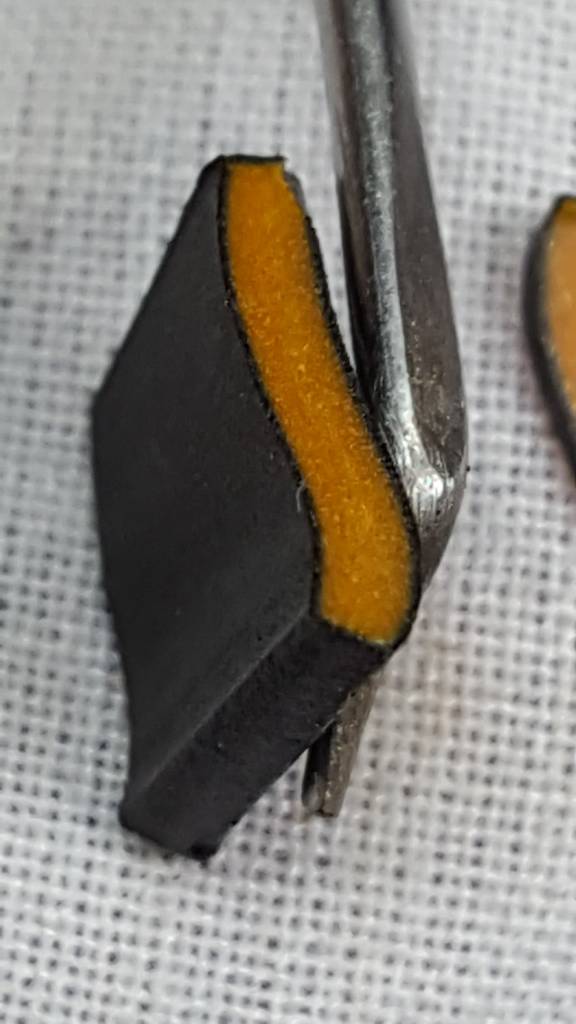

Just curious for anyone who has done this: how deep does the die penetrate? In other words, will a deep scratch show red/orange/white, etc.?
Thanks.
Philbert
Not sure if I posted this yet but here is a piece of oem Stihl plastic that was in the dye for about an hour. I cut it to see how deep the dye went. I was happy with what I saw.
Pretty good for fabric dye, heck that's pretty good for any kind of dye...
