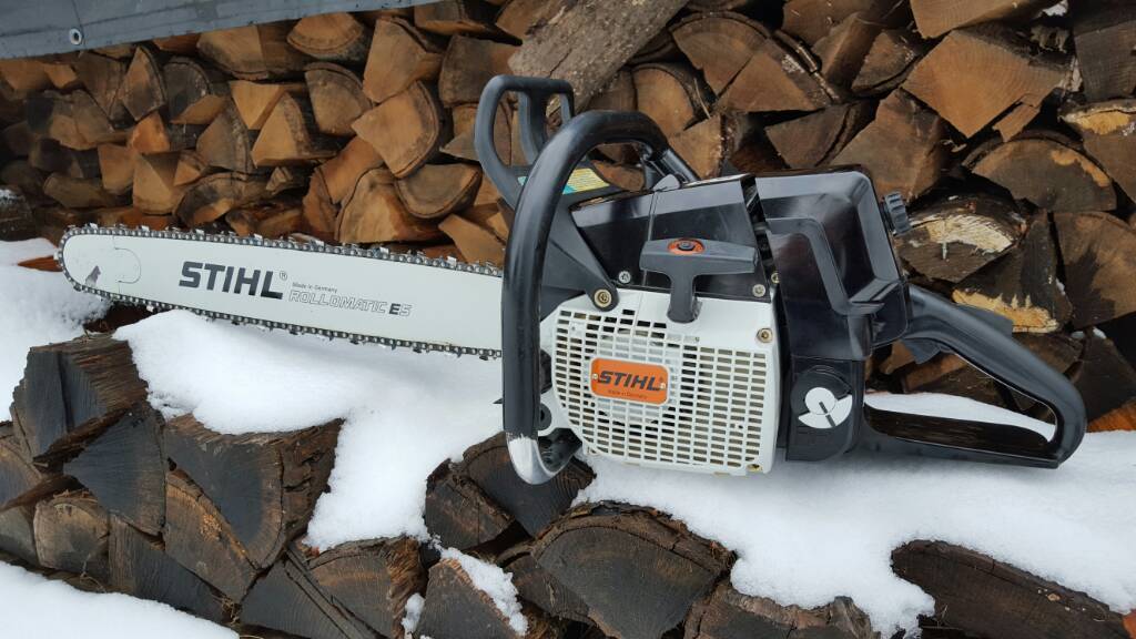

Anybody dye plastic chainsaw parts?

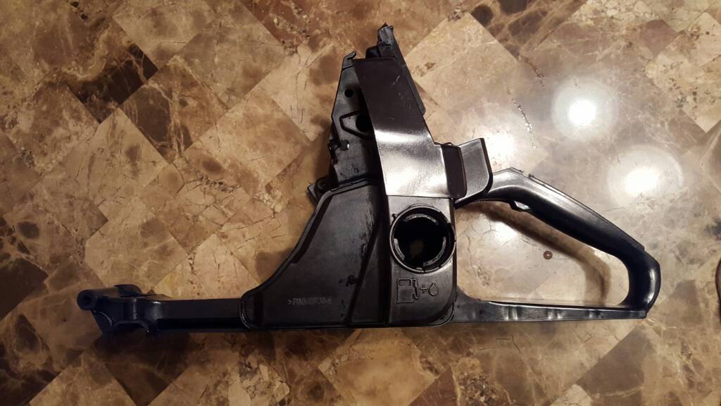

Hard to tell in the pic, did it opaque the tank. Or is it still slightlyvsee through?.
I probably would have used a sacrificial fuel cap to keep it out of the inside of the tank. Not sure what I would have done to the outside though.

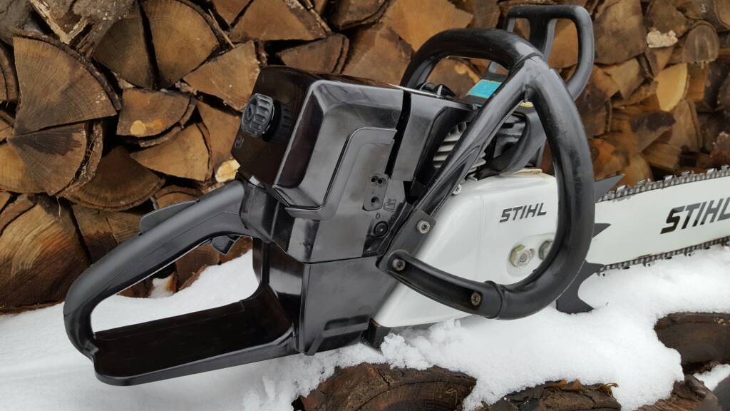

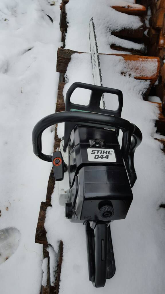

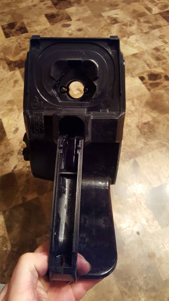

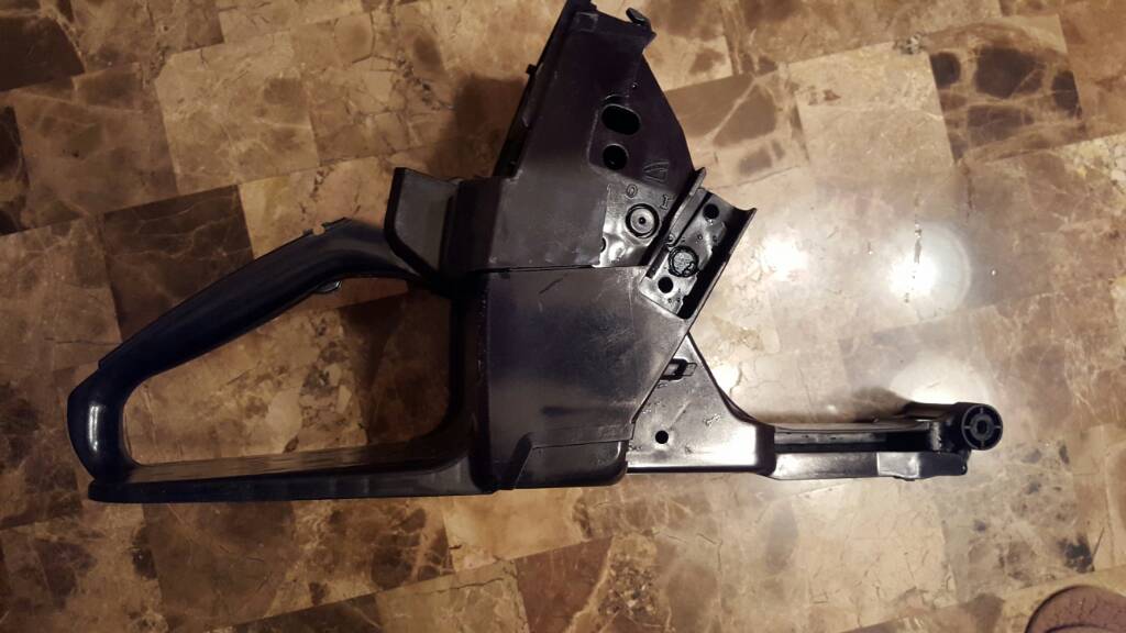

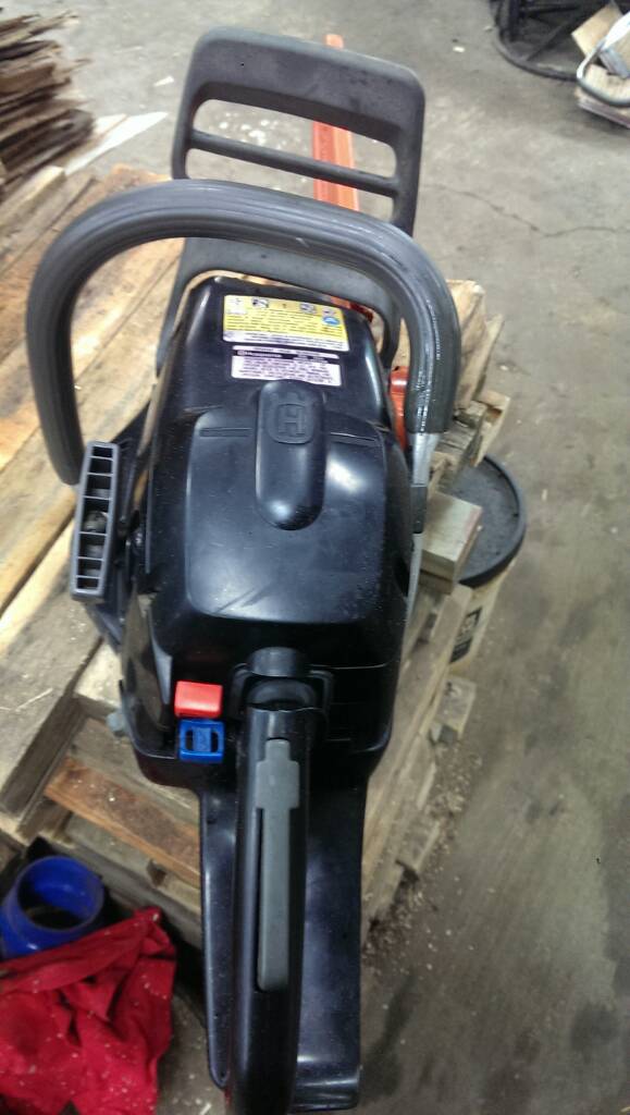

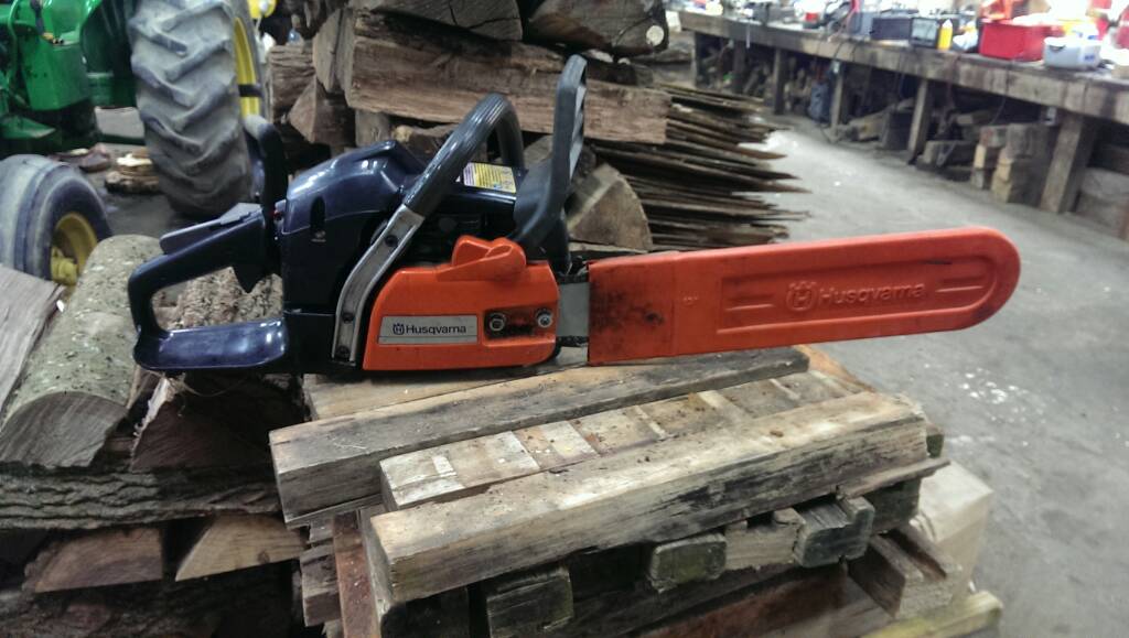

I did use a cap and let's just say it won't be used on a saw! Something leaked and dye got in the tank. When I removed the masking the tank was no longer transparent. So at that point I decided to put it back in the dye and make it all black. It turned out awesome. Indoor pictures suck but here they are. I'll show better ones after work tomorrow!

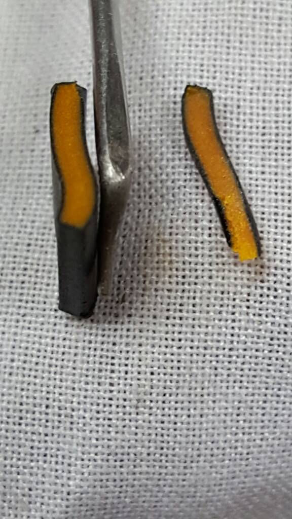

O44 I did a year ago, dyed all the white plastic, painted all the mag, sanded and cleared the orange. The saw looked terrible , I started looking for a new tank and said screw it I am going to try something different. Pulled the orange gas/oil caps from a 029 i had IMG_20160209_212309820.jpg IMG_20160209_212222759.jpg
