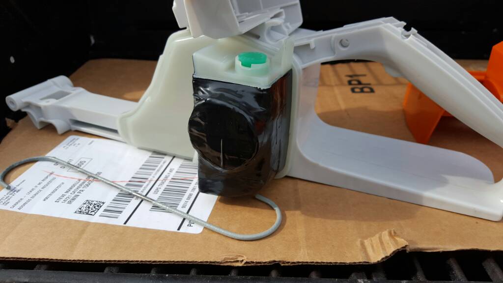

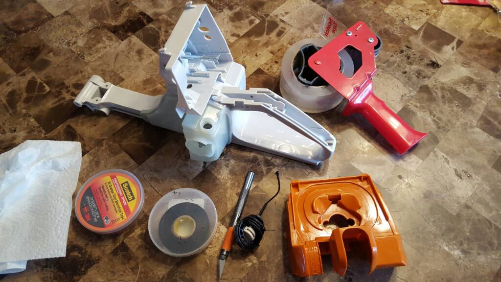

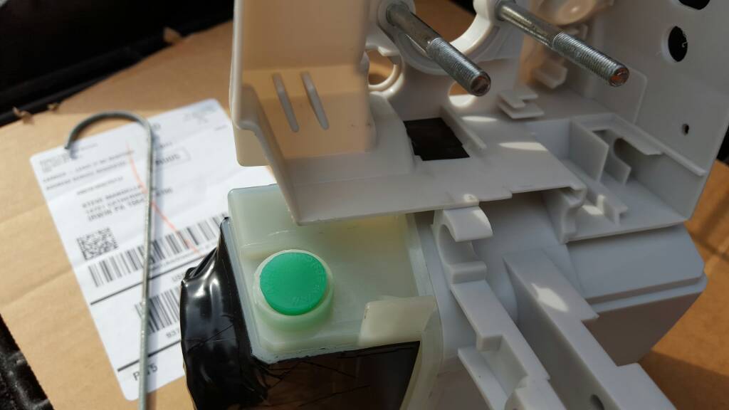

Ok finally got a day off and am going to dye some more parts today. I got the Farmertech tank from Dave and got it prepped for masking.
I wanted to keep the clear tank so I taped it off with electrical tape. I hope it holds! I taped off the fuel line hole and plugged the vent hole.

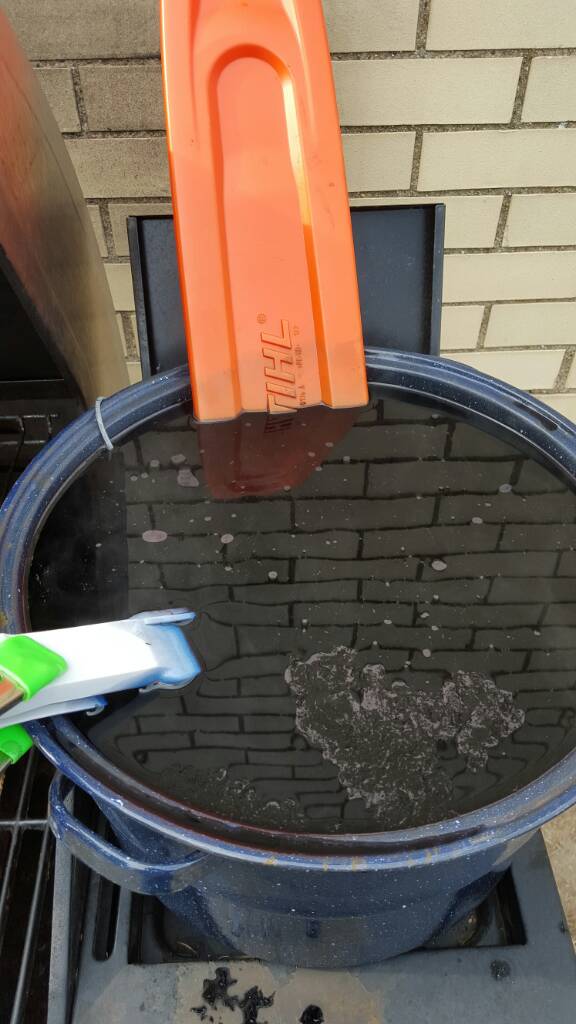

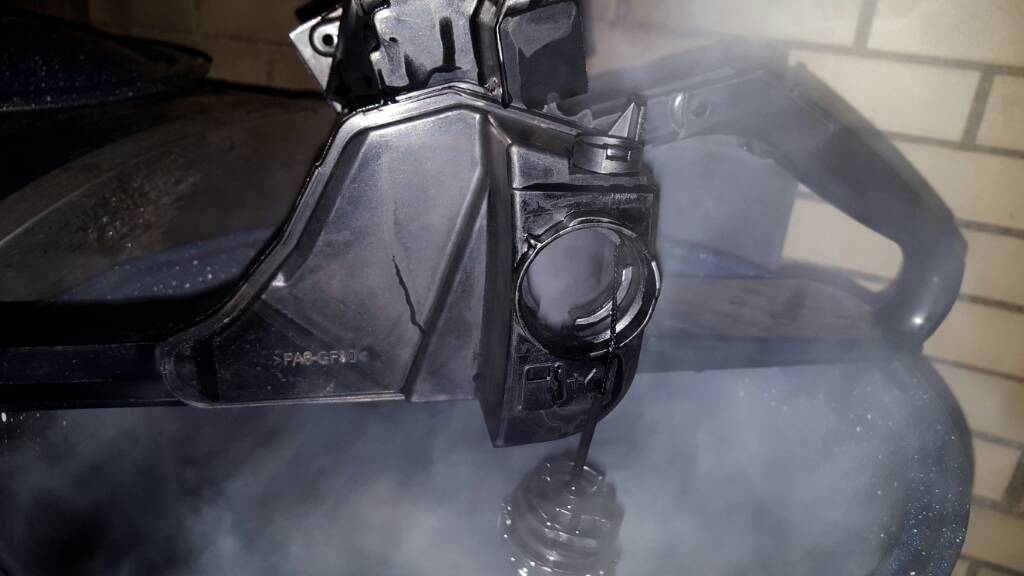

Now it's in the dye along with the carb box cover and a scabbard! The tank floats because I have the tank closed off so I have a clamp holding it. I'm using the biggest pot I have and it was recommended by my wife![emoji6]

Looking good. Can't wait to see how the tape did. I did find when I dyed mine that the dye wouldn't penetrate the oem stickers. They were in good shape so I left them on and it looks like they belong there now.

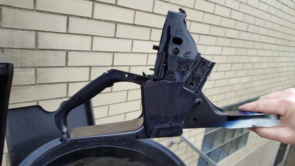

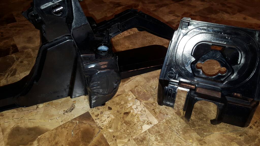

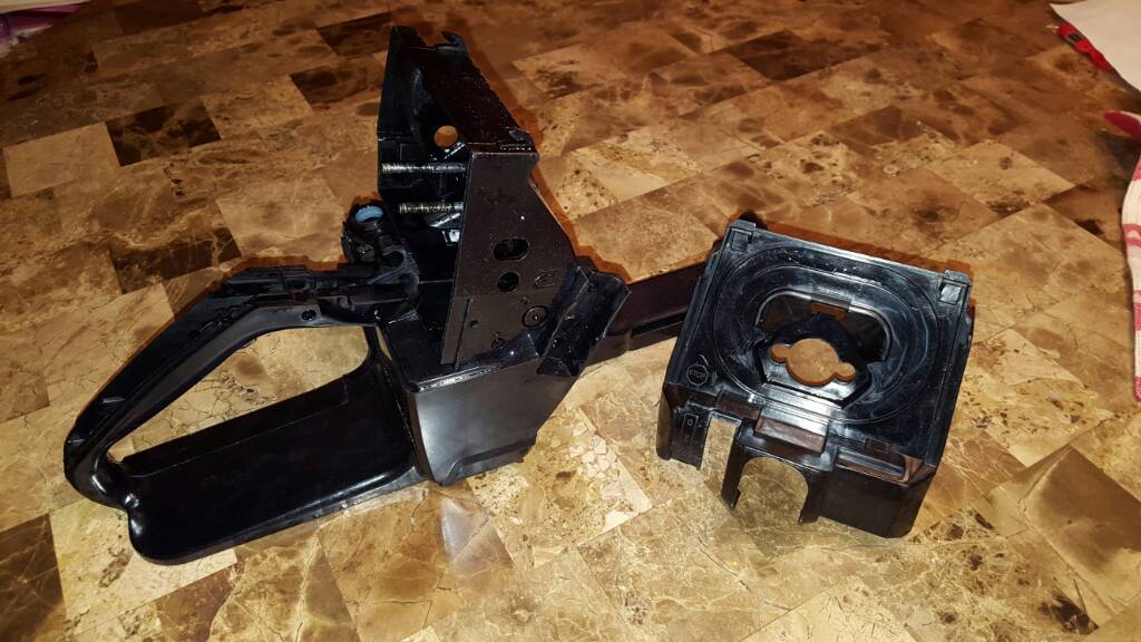

Well it got dark before the whole process was over. I had to turn the heat off for a couple hours this afternoon and run the kids to some appointments. I finally took everything out and rinsed with cold water and pat dry. I already knew that my seal job on the clear tank failed. Here are the parts before I remove the tape and see what's up with the clear tank.

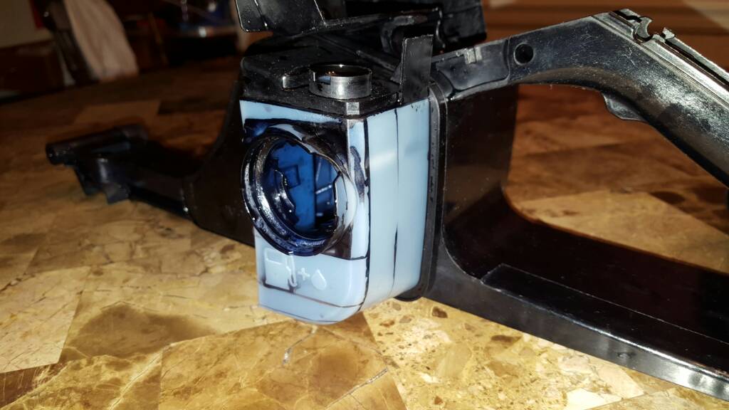

Well the taping off the clear tank failed! The inside got dye in it so I figured it would no longer be clear. Oh well back in the pot to get finished.

Wonder if you could shellac it as a mask. As I recall, shellac is soluble in alcohol, but not water?
Anyway, no big deal to pop a floppy cap to check the fuel level.

I wonder if you sprayed it with clear first it would stop the dye
