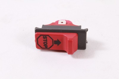

The aliexpress 372?Saw started well this morning 15 ish degrees.
Kill switch has failed. Had to pull choke to shut down. Maybe the cold or maybe it just failed.
Yeah. Got it from Amazon but I think it’s the same thing. Says husqvarna on it but it’s spelled all funkyThe aliexpress 372?
I put those auto on Husqvarna trimmer switches on my saws they work perfectYeah. Got it from Amazon but I think it’s the same thing. Says husqvarna on it but it’s spelled all funky
Yeah, same as i got from Ali.Yeah. Got it from Amazon but I think it’s the same thing. Says husqvarna on it but it’s spelled all funky
Yep same as mine.
Are they all the same or is it a specific model?I put those auto on Husqvarna trimmer switches on my saws they work perfect
Those clone switches go bad all the time.
Doesn't look like that one will work in my saw unless I add a ground wire. My saws only have one wire and screw to case for ground.I believe the auto-on switches are part 537419001. Currently have one in my shopping cart, for a Makita 6421 build.
Hnsavrqua - cornering the dyslexia market.
whoops, sorry to lead ya down the wrong path there!Doesn't look like that one will work in my saw unless I add a ground wire. My saws only have one wire and screw to case for ground.

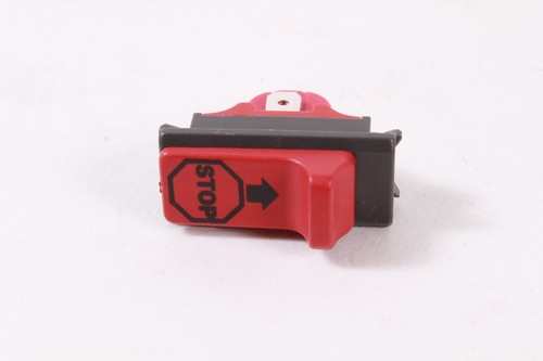

This oneDoesn't look like that one will work in my saw unless I add a ground wire. My saws only have one wire and screw to case for ground.
That's the same part number as the previous posted one. How does it ground to the crankcase?
I just replaced one on my 272, one end just goes to a screw against the case.That's the same part number as the previous posted one. How does it ground to the crankcase?
OK. From the pic it didn't look like you could screw the screw into it.I just replaced one on my 272, one end just goes to a screw against the case.
