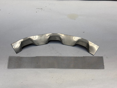

Has anyone tried these deflectors?
No but I've used dozens of joe harkness's
Red97 deflectors
I just order a variety
They've worked perfectly.
