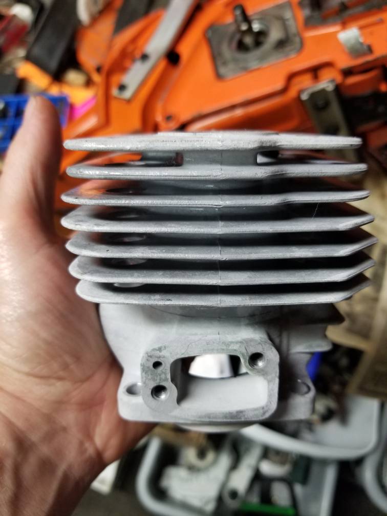

Ya I found there was a bronze worm gear and plastic one on the early 281's and then I believe they share with the 395. I got a worm gear from D Dave and it's too big. So now I'll order the right one and maybe get her back to running next weekend. Piston and cylinder cleaned up nicely!

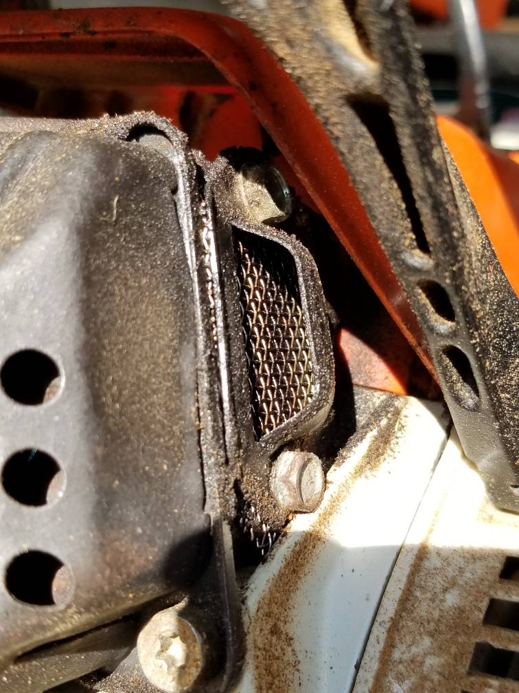

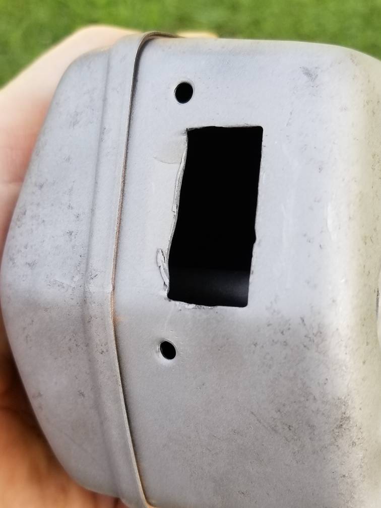

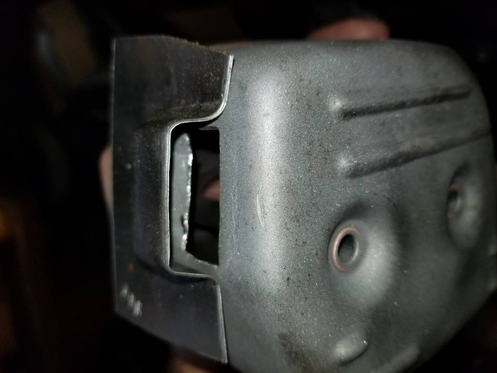

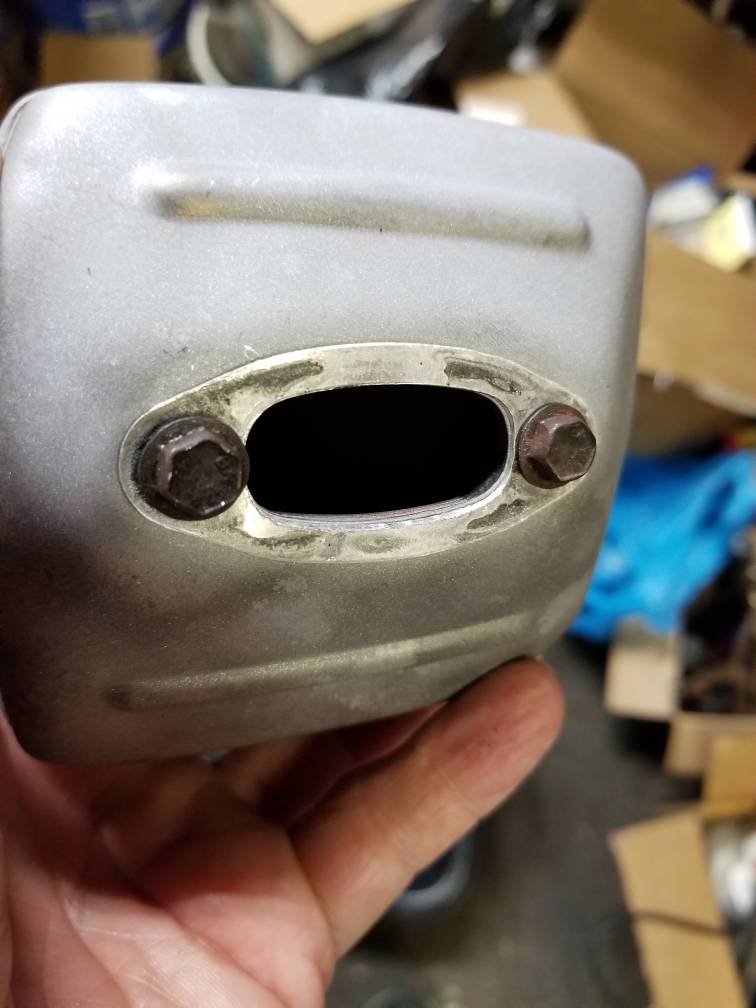

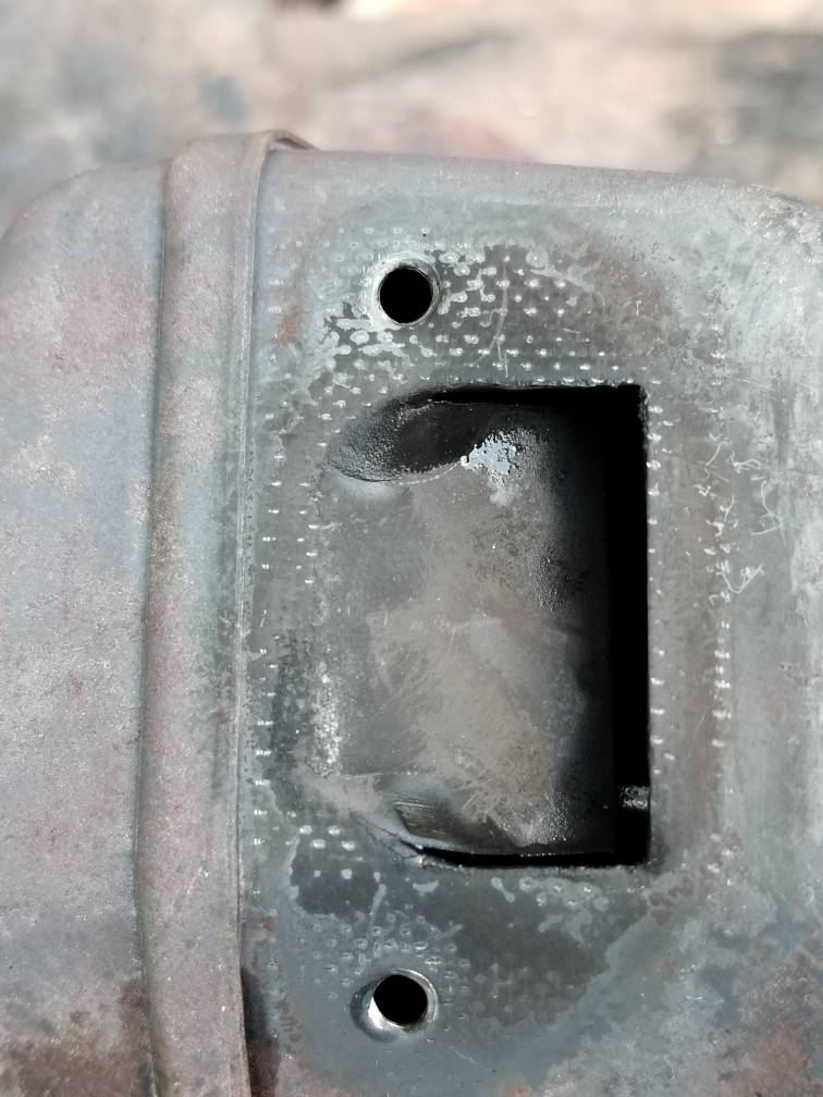

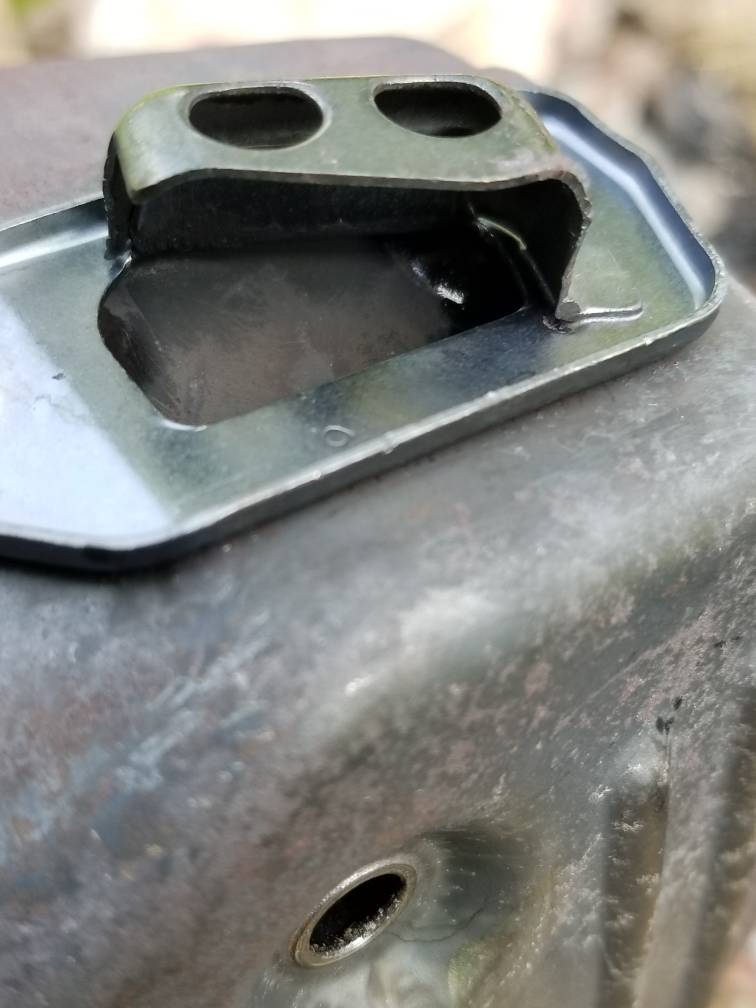

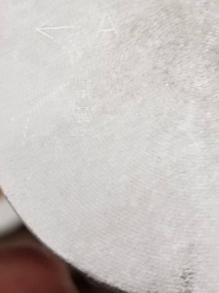

View attachment 136858 1992View attachment 136854 1999View attachment 136855 1999View attachment 136856 1992View attachment 136857 I've got a question on older vs newer 288's
I came across a similar deal as JonCraig a few weeks ago except it was for two 288's. Neither one runners.
Looking to make one a runner for now and the other will be a complete tear down.
One seems to be a 1992 and the other is 1999 for sure.
We're the older versions a 52mm and the newer 54mm? They seem to measure that way but I don't find that info on line.
Was able to make the one a runner.
Still needs some love.
