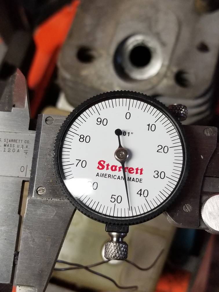

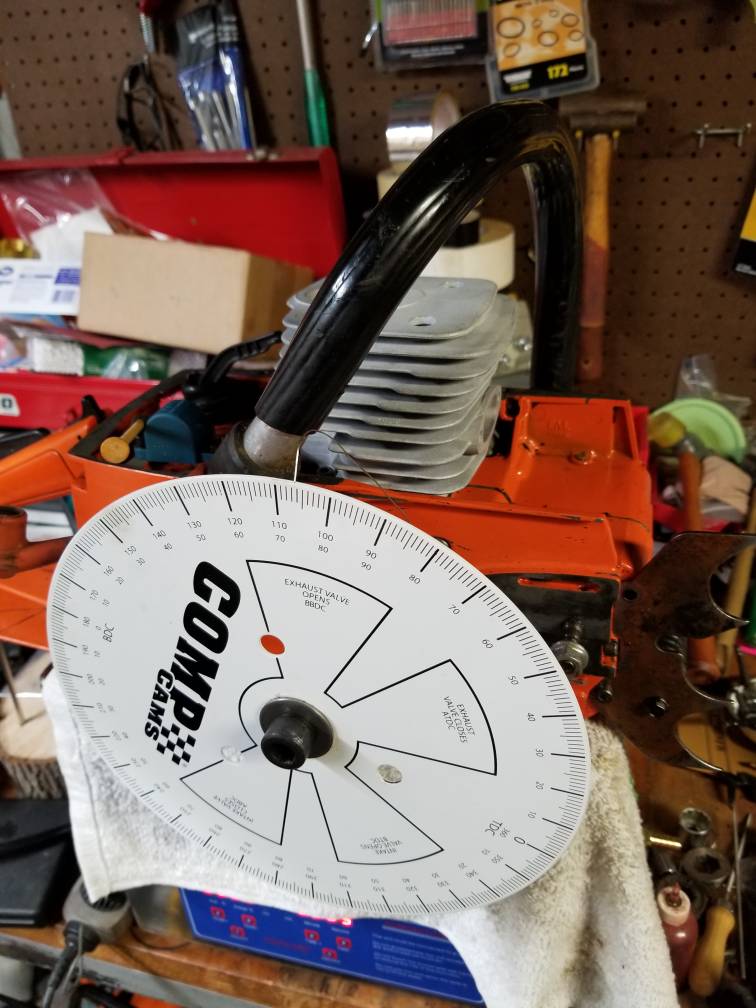

Ok thanks to @rattler my head really hurts. However I have a better understanding of a degree wheel and port timing! Thanks Mike!
It will be easier next time, then you’ll be looking at CC specialties handpieces...lol!!
Are those numbers with or without base gasket?

If that were mine I’d take .020 off intake skirt, little timing advance, no base gasket and muffler mod. That would probably wake it up a bit. I did a similar thing to a 394 and responded nicely.

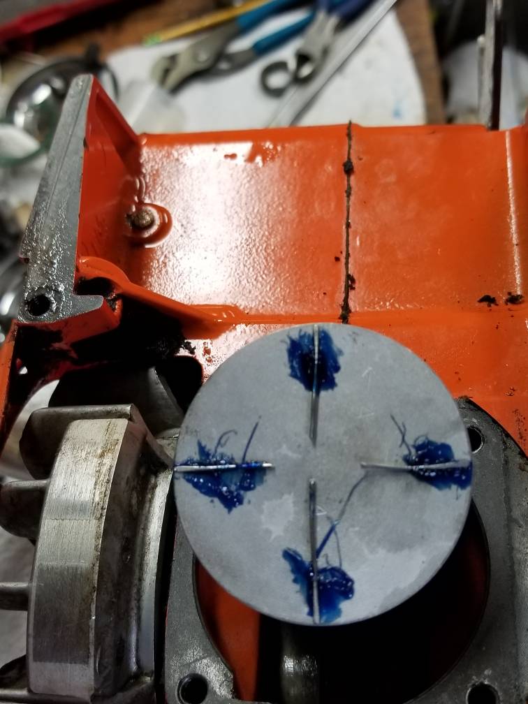

With no gasket it's much tighter than I expected. My with gasket measurement had to be off a little. No exhaust side measurement that piece jumped out of my hand never to be seen again!
That’s a perfect squish #

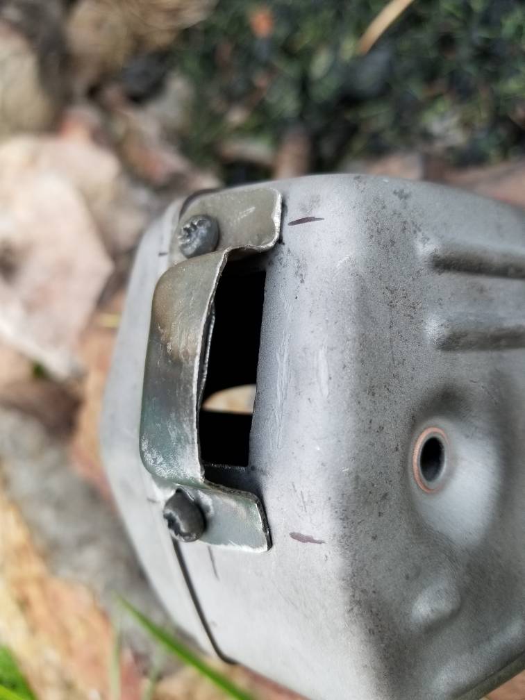

Just picked up the muffler from the powder coat shop! Oh my does it look sweet! Best Husky muffler I have ever seen. How does a 31 year old Husky muffler not have any dents?
Nice [emoji106]
