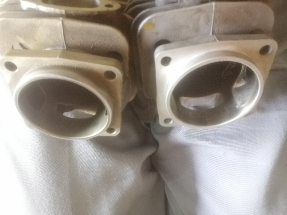

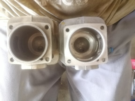

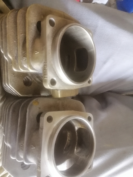

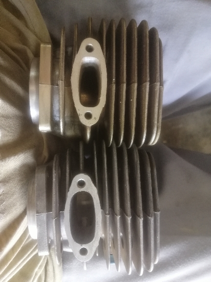

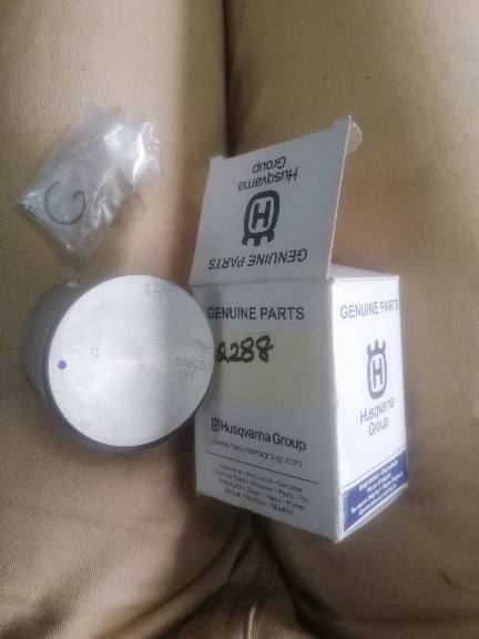

Just finished a 288 ported work saw build, new oem piston kit. Base cut and squish band cut, final numbers are 100,120,80 with 0.027 squish. Comp is good pretty good without break in, will test it out soon

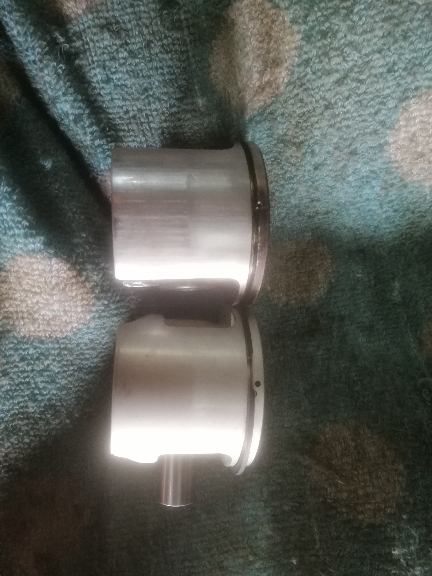

This test will be very interesting for me, AM piston had more compression. Musta been carbon deposits and ring seal it had. Now with oem piston kit comp is definitely lower but timing has changed alot. This will answer a question that's been lingering in my head for a very long time.
Compression vs port timing, which gives more power at what rate and how much. Obviously its a feel for me i cant describe or proof in papers, but running saws this long has given me some sense to "feel" torque, rpm and throttle response. I'll report back how it goes
