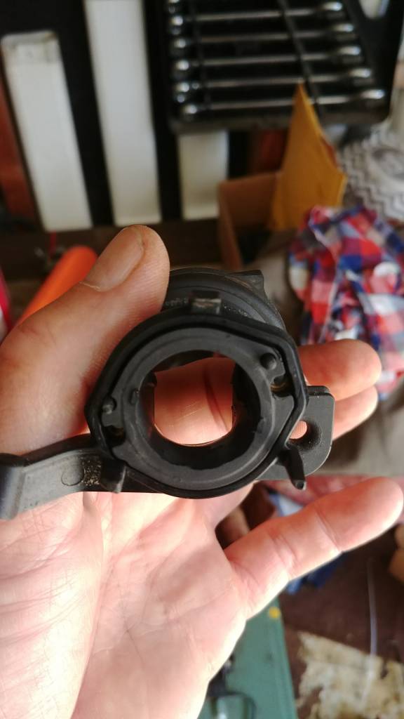

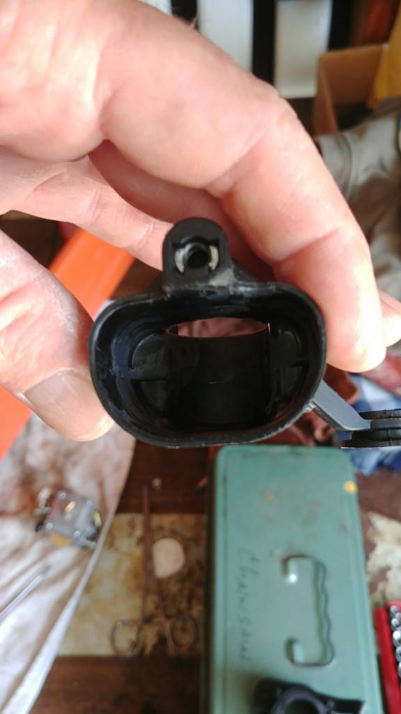

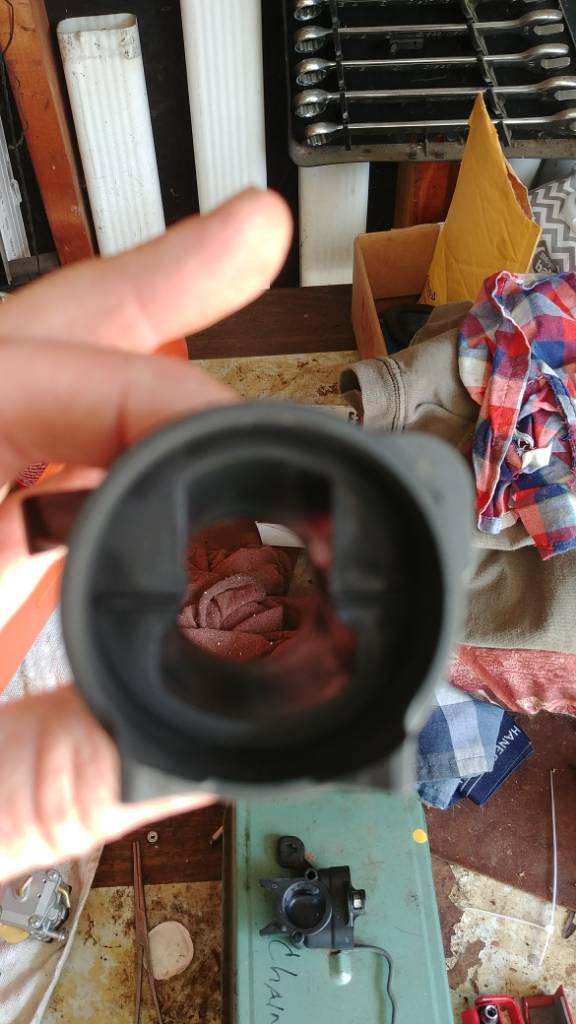

Here's a couple pics with the divider cut out of the filter holder and intake boot.

I know it’s been a minute since I’ve posted in this thread , but I just wanted to report back and say that cutting the baffle out of the intake fixed the issue. I did have to retune, but the saw runs perfect. Thanks for the help and I hope others will find this thread now if they try the carb upgrade. It’s definitely worth it. I can tell the saw is snappier for sure.
