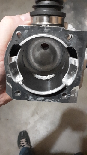

Got any pix of how u got the transfers to line up? The gaskets on the 372 and 385 are quite different
For what it's worth:
I hogged the front transfers out to make them line up. There's alot of material that can be removed. Also narrowed the front skirt. It did take some throttle response due to velocity losses. If I were to do it again I'd leave them alone or add to the case side cutouts.
I used a cheap hutzl 390 cylinder+piston, caber rings, 2mm spacer plate, 390gasket + sealant, 066 rod 36mm 372 crank, china 395 carb, and junk 2015 372XT cases bored to fit the 390 skirt. Ended up with .021 squish 100ex, 125t, 77in. Cut transfers to 120. So far it only free revs to 12100. Before porting it ran 10500 free and in the cut with 24" full comp square at 9-9500 green hard maple.
Real machining and quality parts would've been helpful to keep case volumes down and play with squish. I ended up with 125lbs compression so it's no real powerhouse.
For a hack job it's decent and a good learning experience. It's become an ongoing project now on hiatus as I've shifted focus towards my dirtbike project and have no real need to cut wood neither is any available close to my residence.
Sent from my SM-S767VL using Tapatalk
We all have to learn from our mistakes I think it looks good I ruined 1 cylinder before I had a running saw even after doing four cylinders now I’m still trying new things with this setup I have one now I putting a 084 stihl carb on
