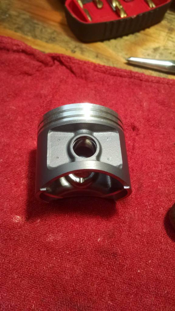

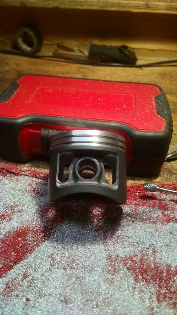

I agree Tor, definitely a last option for me but can be doable if it comes to that. I wonder, is it possible to open up the sides of a Meteor to make it so it has the windows??? Seems like it might be doable with an OEM piston as a guide?

No different than windowing a piston for a 371/2 I have done this on a 51 piston for a cp55
yup, I am pretty sure there is enough meat to do it.
Ill dump it in my 242 project and mark where the skirts are placed in ex and in port for you.

Working with meteor pictures for ya
