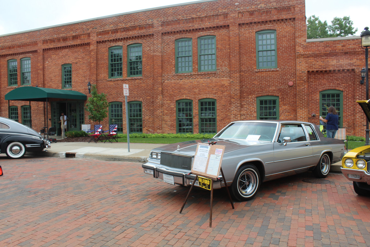

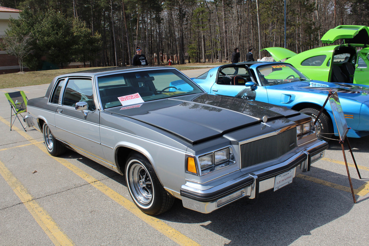

this is our Buick. 1985 LeSabre collectors edition. Belonged to my mother in law. A Michigan car bought and driven.
Back to the Bricks 2018 in front of GM factory #1.
