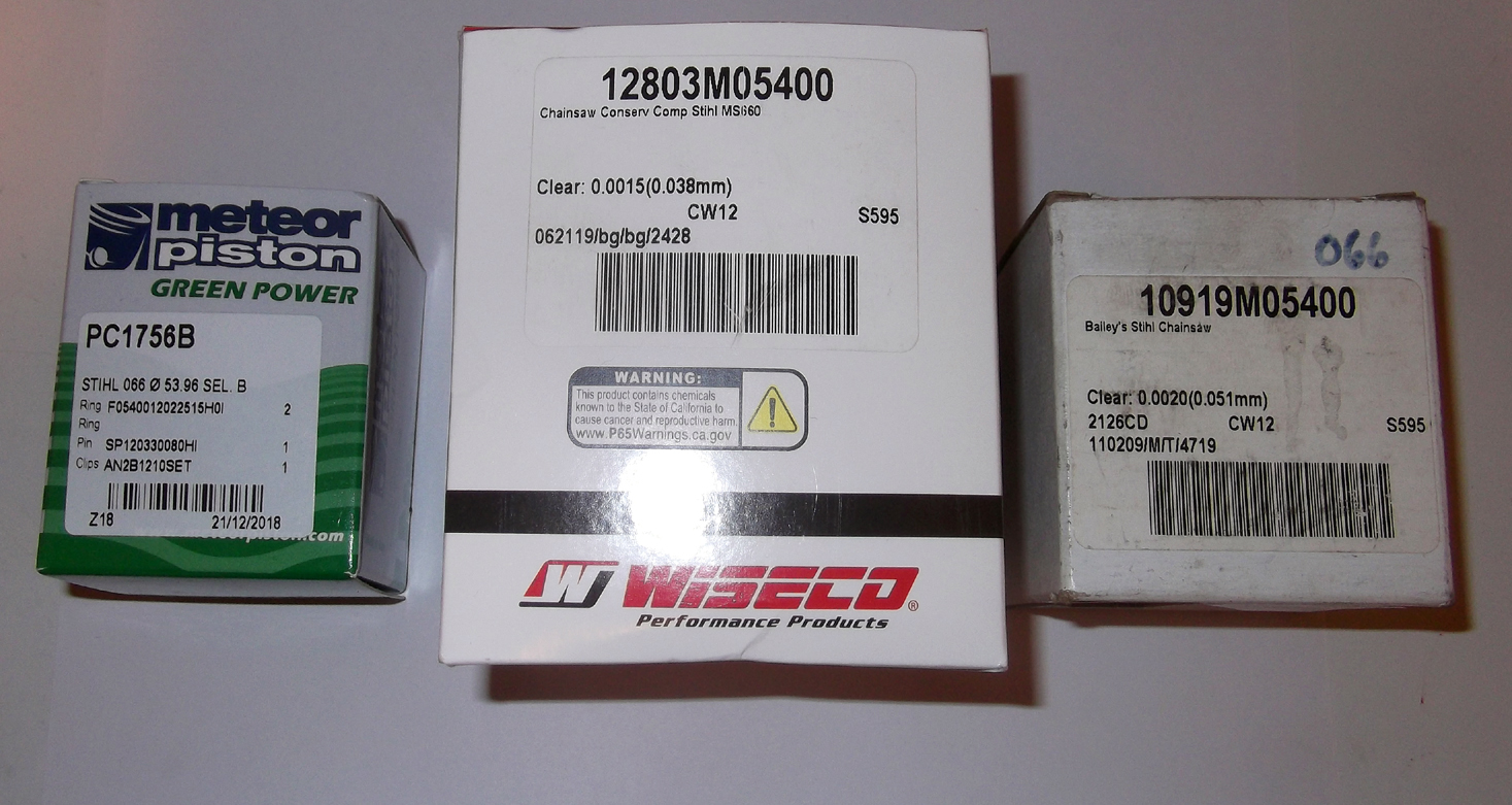

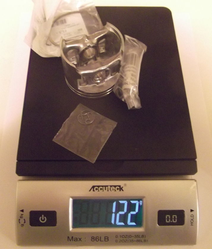

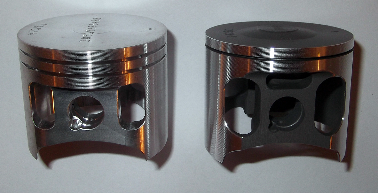

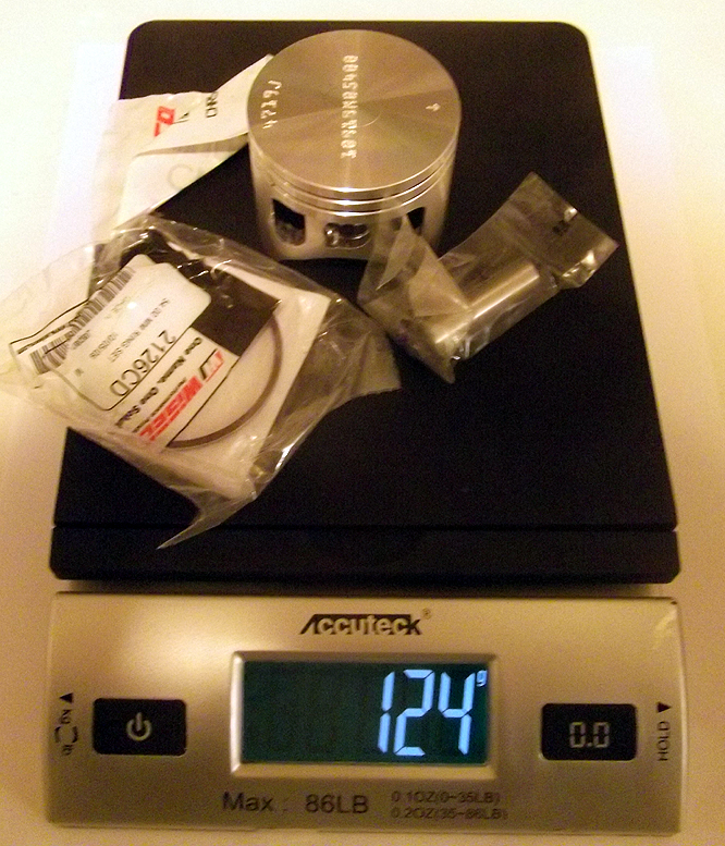

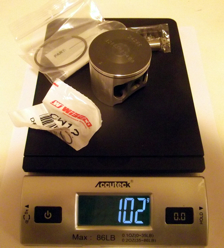

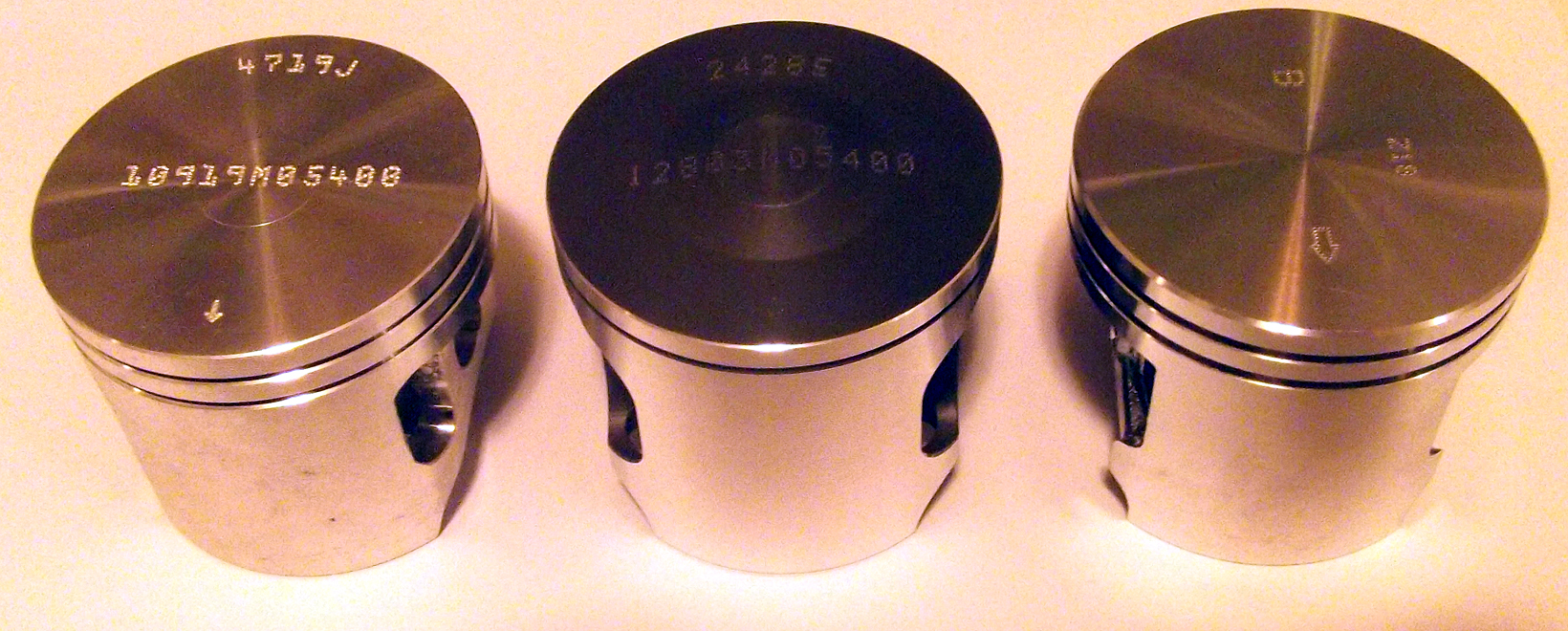

I bought one of the "new" style Meteor 066/660 pistons a while back and wanted to compare it to one of the new Wiseco pistons that Dave is offering.
I also have one of the original dual-ring Wiseco pistons that Bailey's was selling years ago.
jacob j.
Only the weird
9:44 AM
232
9,780
67,251
Coastal Oregon
The fit and finish on Dave's piston is by far the best. The Bailey's piston isn't bad. The Meteor piston is decent, but not on the level of the Wiseco slugs (as to be expected).
Dave's piston is in the middle.
