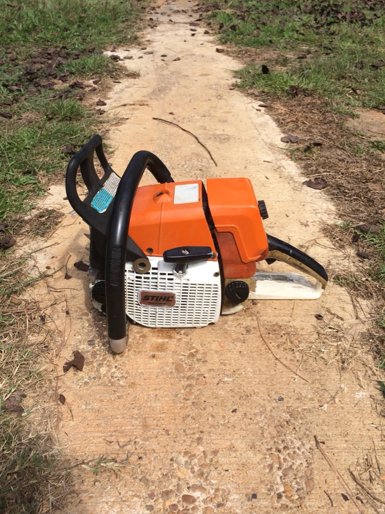

Cheers guys I might try the mallet method. That is if I can get this stupid cylinder bolt out, rounded the bugger completely. Any ideas how to get it out? I've tried tapping in a larger size torx and even a hex but it just keeps getting worse. Driving me nuts!

Got a welder? Or dry/blow the lube out and pound in a bigger torx. Hit it in like you mean it. Use something to put downward pressure while you turn bit with a wrench.

Is there any part of the torx slots in the head left? If there is just get some heat in there and try again while putting down pressure on it. Or you could JB Weld the torx tool into the head and then burn it out after the bolt is out. Or failing that, like Matt said, welder.

Also put the other 3 bolts back in tight. If that’s the only one left there could be some pressure on that bolt making it harder to turn.
If there’s enough room I would try vice grips clamped onto the head of the bolt.
