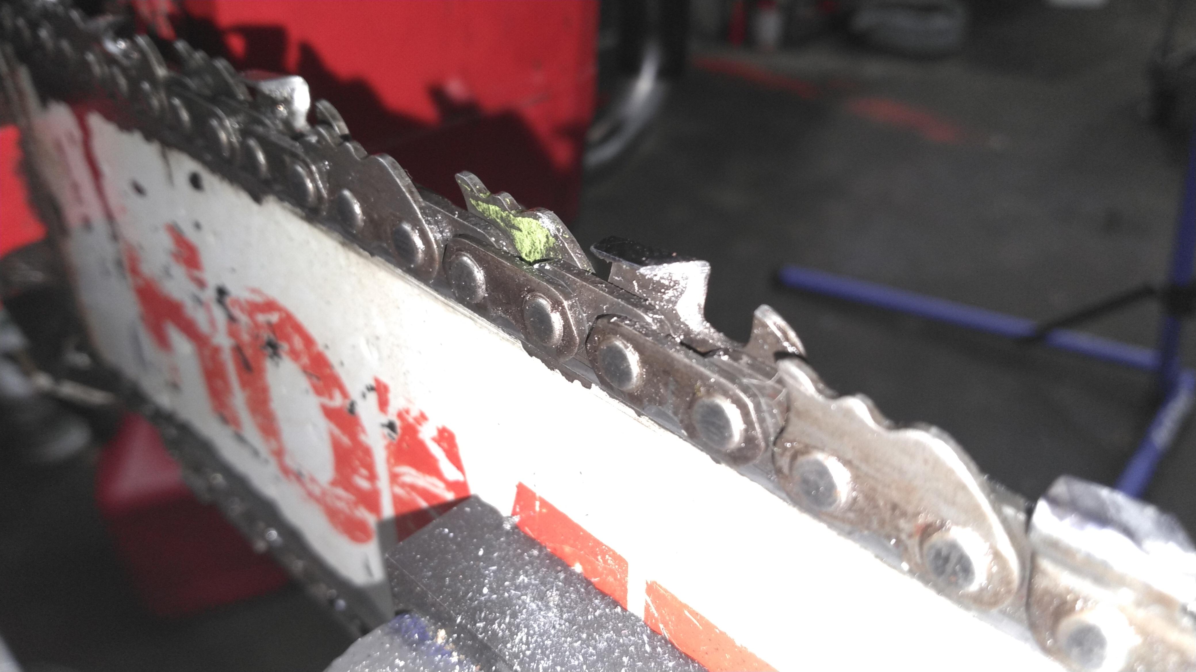

My first time sharpening, how'd I do?
WillG
6:28 PM
10686
Oct 10, 2019
1,728
9,039
Norwich CT
Just touched up the chain on this Homelite 330 I repaired for a customer, chain wasn't too bad but just needed a touch up. 6 strokes on each tooth had it looking pretty good. Didn't touch the depth gauges at all. Used an Oregon file guide and Oregon file. 30 degree angle. And yes I know it's a safety chain however the customer just needs it to be sharp.

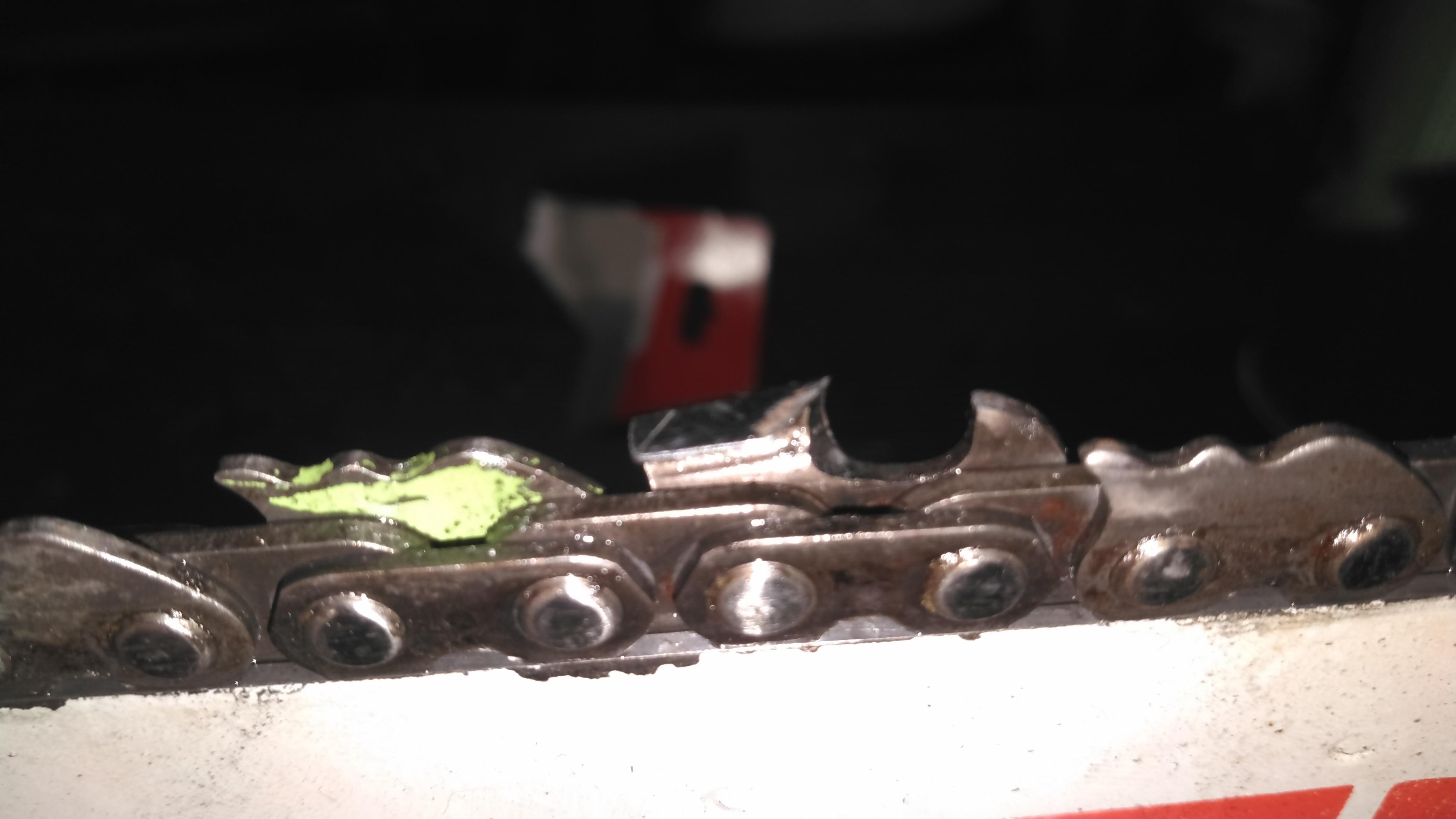

How bout a picture from the other side. That’ll help see what kind of hook you’ve got.

There should be a thread with tips on taking pictures of chain. It's tough and some folks on here are very good at it!

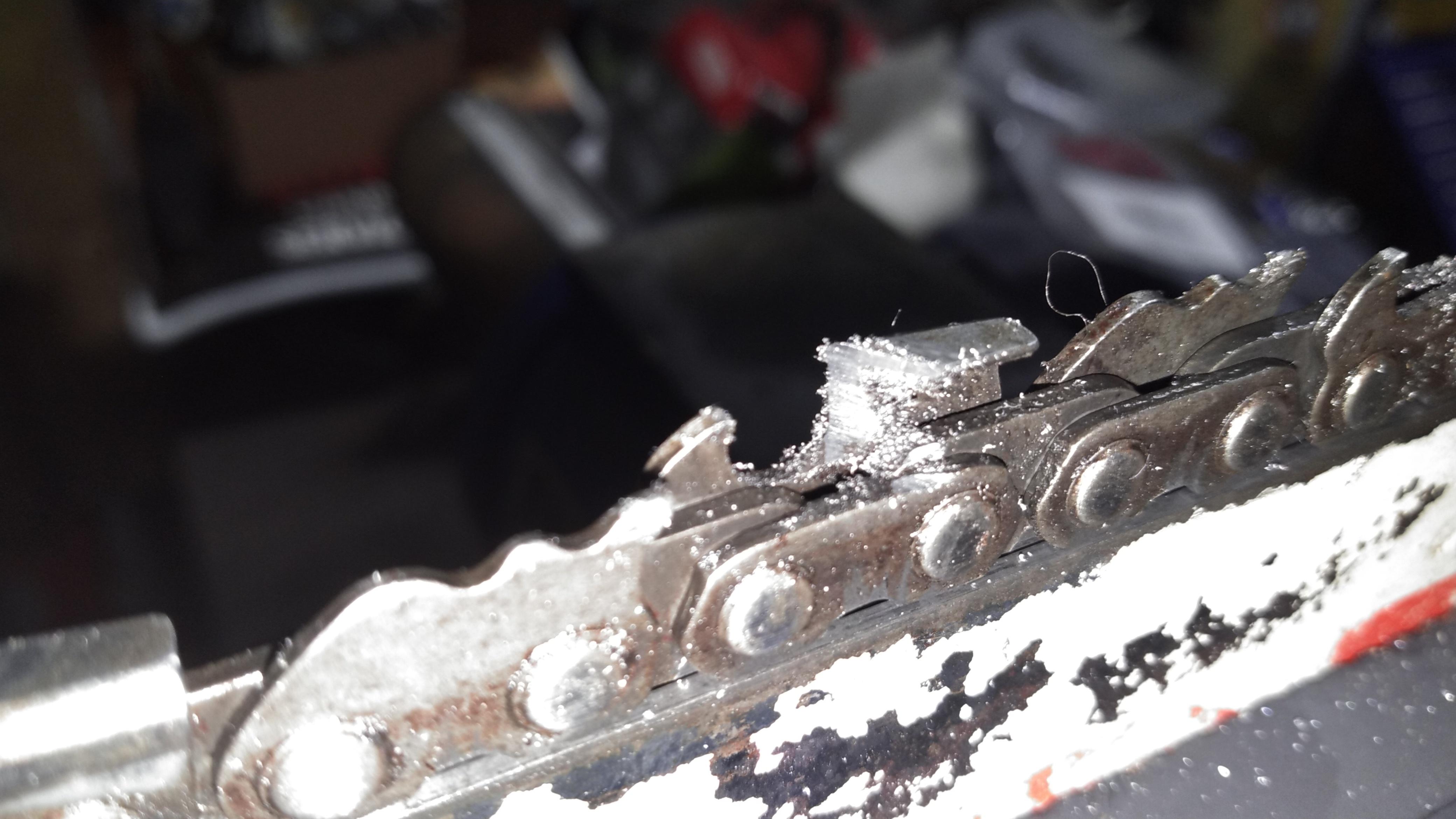

It looks like you need to be deeper into the gullet and get the file under the tooth a little more. 20200123_142500.jpg
