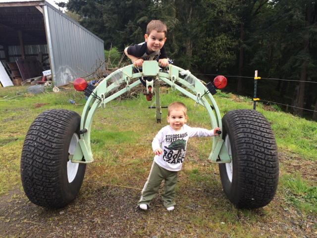

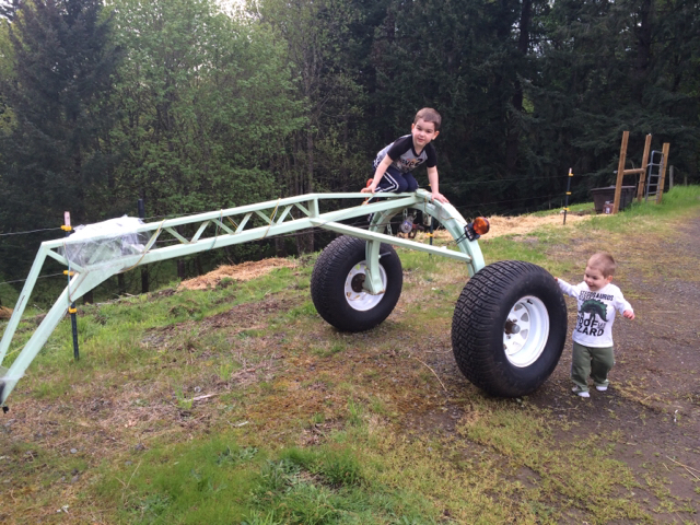

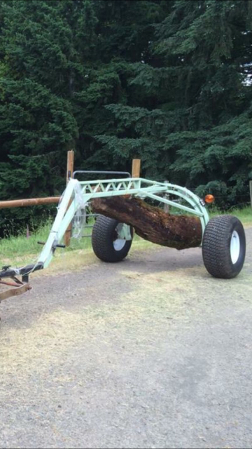

Here's mine. It was built by a guy here in Oregon who went on to sell the design to Logrite. I've pulled some big logs with it. Need to replace the hand winch with an electric though.

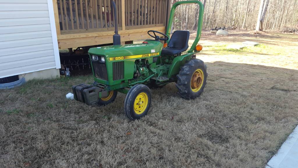

One I was eyeballing the other day that a tree service I work on saws for has.
I am fixing to take some trees down here and hate to just block it all to fire wood but this little machine won't be moving too much with out assistance.

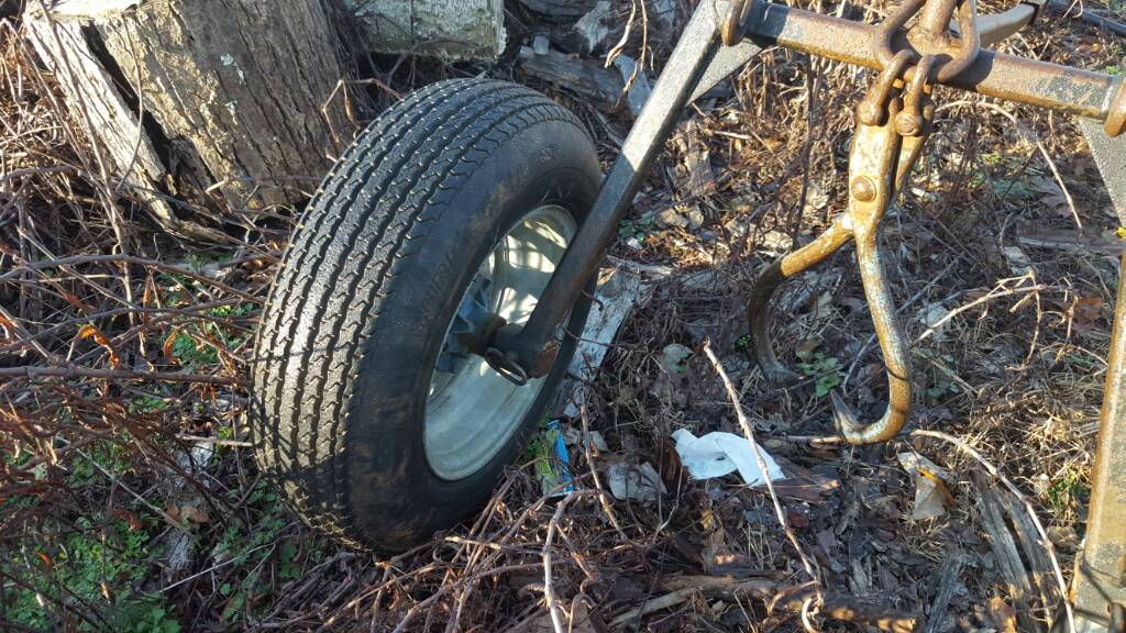

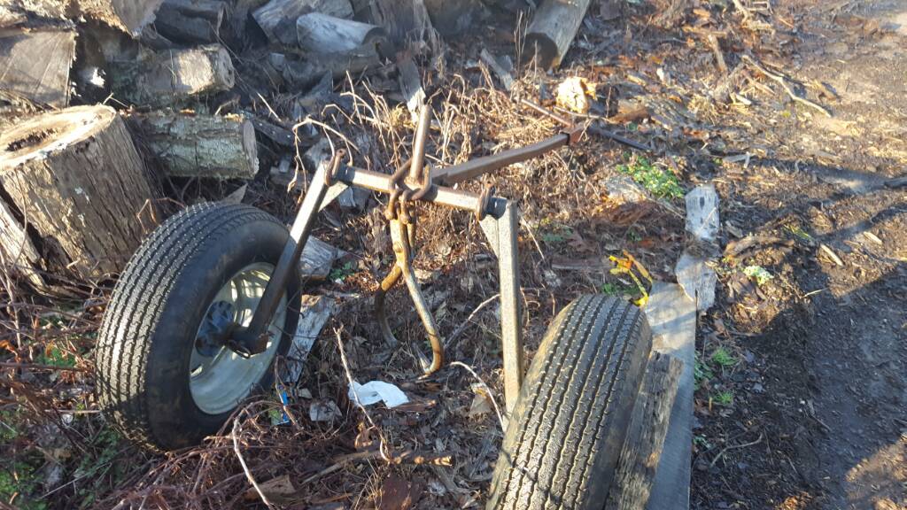

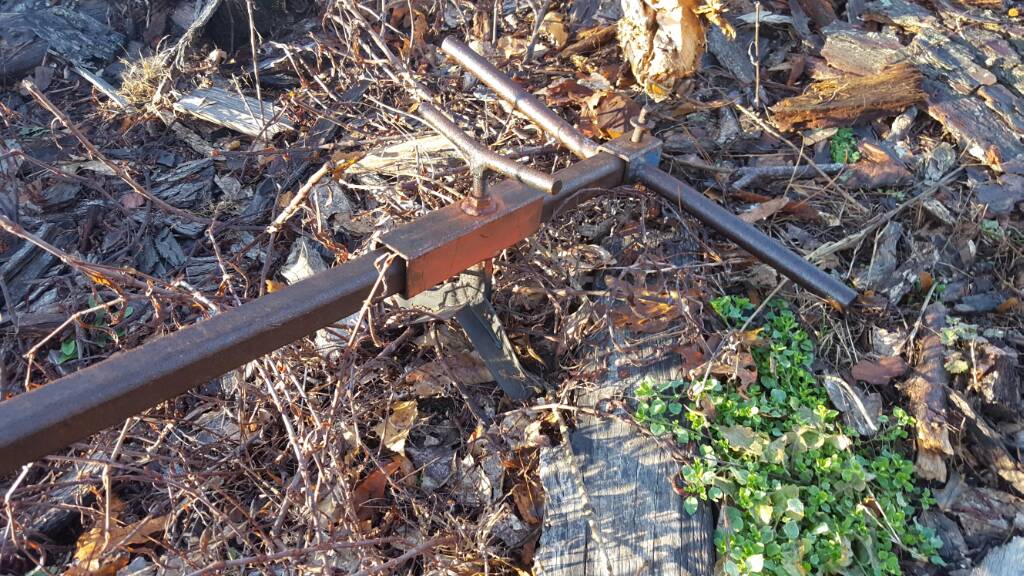

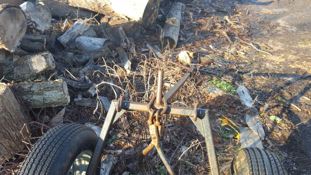

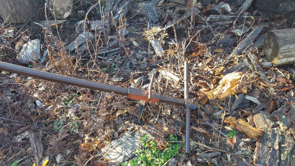

Mine is the low tech, low cost design, but it works for it's intended purpose, and it had to be something I could slide mostly under the ATV and still fit in my 5 X 8 trailer, so it was "purpose built" for that.
Also, since my upstate NY property has been / will be logged, nothing exceeds 20" any way.
The trick to it working correctly are the pivoting angle irons that keep the log centered, w/o them it tips over around sharp turns. We lift the end of the log with a timber jack, and purposely the end of the log drags as my property has some steep hills and I don't need the log pushing me down faster.
