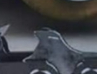

That Stihl Hexa chain ad is kind of dumb with no mention of the new 6 sided file.
Looks like a .325 to me, I like to know what that file's part# is.

See beyond the Stihl Hexa safety chain in that advertisement.
Yes it is a green consumer chain and with a side plate hook like that Stihl has to cover their ass if a weekender stuck that on their MS391. Easy enough to make it non safety for a guy who wants to grind the ramps off.
Most guys would be interested in that unique file where he can put that Husqvarna X Cut style of grind into his 72LGX chain with a easy filing stroke of a round file.
Just don't get carried away lowering the depth gauges, Lol.

With that much side plate hook with a round file would make a very weak cutting edge. Slightest bit of dirt would dull it fast.
This Hexa file would make a true flat chisel profile severing wood fiber much easier with less effort then a round filed profile.
When I say "true flat chisel profile" I mean the same profile as a hand wood chisel or a plane.
I'd like to try it out on my work chains. I'd imagine a standard 30° top plate angle would help the sideplate profile cut a bit better then say 15° chisel bit spec.
