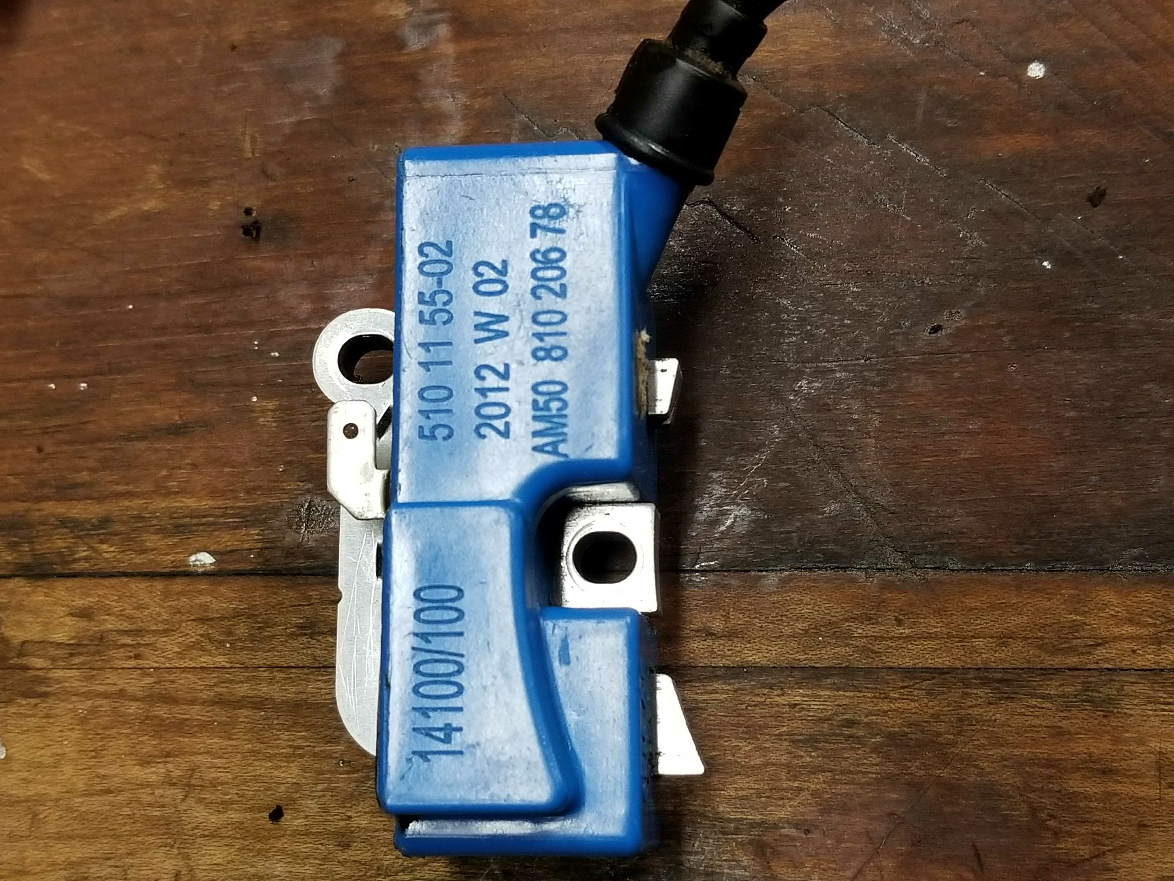

How many different coils were used on 346's? Here's what I got should I look for a different one?

4 blacks and 1 blue
Blacks was:
544 04 70 01
537 16 21 01
503 96 24 06
503 96 24 04

7 blacks and 2 blues.
Blues:
510 11 55 01
501 32 38 01
Blacks was:
544 17 19 01 (used on 350 EPA)
544 04 70 01
537 16 21 04
537 16 21 01
503 96 24 06
503 96 24 04
503 96 24 02
Forgot a couple...
Like Matty said Dan, you really want a black unlimited coil for your 346, but Randy makes good use of those 14,100 coils on larger saws that don't need to turn crazy RPM.
