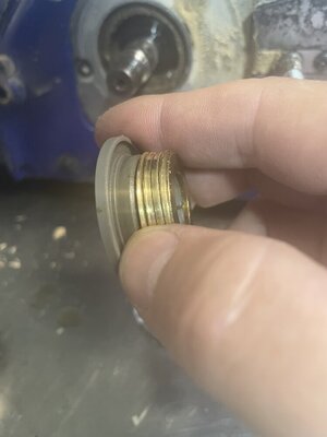

srcarr52 Shop rat, backyard slice cutter. GoldMember Local time 11:59 AM User ID 522 Joined Jan 12, 2016 Messages 3,943 Reaction score 26,001 Location Iowa City Oct 30, 2023 #3 I had a problem with my G395 a couple weeks ago. The oil pump locked up and took out the worm gear. I took apart the oil pump and polished and deburred the ramp and it seems to have fixed the issue.
Nutball Here For The Long Haul! Local time 10:59 AM User ID 7732 Joined Oct 31, 2018 Messages 4,042 Reaction score 11,037 Location Mt. Juliet, TN Oct 30, 2023 #4 I've always wondered if hydro locking can cause the gears to strip of the oil hole in the bar plugs.
srcarr52 Shop rat, backyard slice cutter. GoldMember Local time 11:59 AM User ID 522 Joined Jan 12, 2016 Messages 3,943 Reaction score 26,001 Location Iowa City Oct 30, 2023 #5 Nutball said: I've always wondered if hydro locking can cause the gears to strip of the oil hole in the bar plugs. Click to expand... It was definitely a burr inside that caused it. I could spin it over by hand and it would get caught up at the same place just about every revolution.
