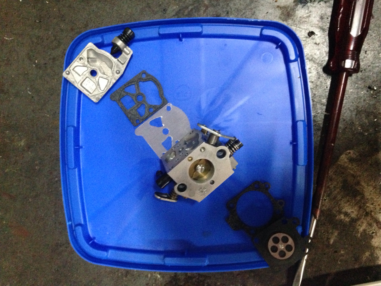

I'm betting the gaskets and diaphragms are out of order.
Metering Side:
Gasket against carb body then diaphragm
Pump side:
Diaphragm against carb body then gasket

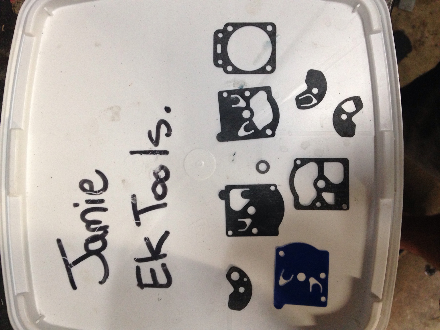

Here are some picks of what I thought went in the carb and what came in the kit.

I think you need the blue pump diaphragm instead of the clear-ish one. See if blue flaps cover fuel holes in carb body.
Also, remove needle and clean it, make sure hole under needle is open.
