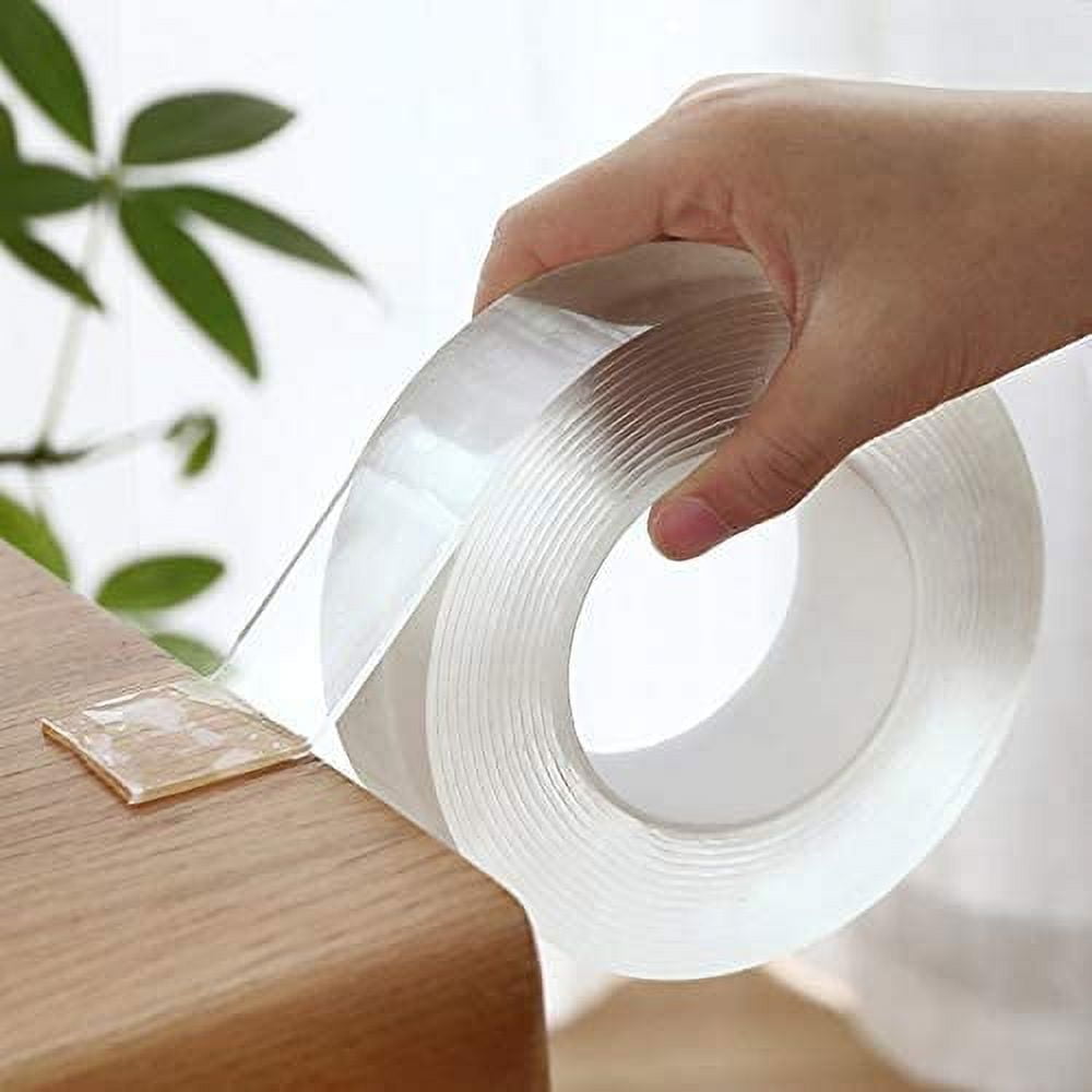

As a side note to the OP ,the best and strongest holding double-sided tape I've used so far is the
transparent PU "gel" tape.And is
reusable as well ,after washing it with plain water.

That’s pretty neat! I have the 3M heavy duty 30lb double sided tape now. The website amuses me “made-in-china” lol. Just got my ported 2512 from huskihl and I dyed it black and got a 1/4 pitch 12in bar for it. I haven’t got another echo sticker for the flywheel but I think it’s kinda cool without it. I was thinking about finding a tach I could mount to that sticker location
