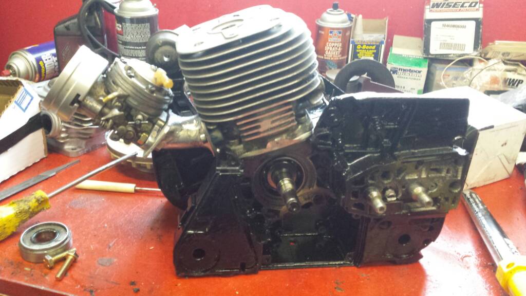

Lookin to play around with the 090 some. I think it would be cool to run it in the unlimited class. I have 2 jugs so I can go wild on one of em. Just don't know much about what it takes to get one of these monsters to be fast.

this was the before pic...I can't find the after pics...but it was some serious carnage

You planning on runnin 2 carbs??
:D
Nice work man
Well I could I would need to get the lower face of the crankcase machined the same as the top ........... there was a fella out here in Australia who did just that his Name Chris Brown .. Chris had a lower kart manifold cut and welded to the lower face Chris has been gone now by quite a few years
I worked out he did it and copied his work on an old cylinder that was knackered I have te manifold so I just have to fit it to a spare 101 cylinder I have
That's awesome. Is this a work in progress or is it complete?
Wonderful make Bob, very impressive.
