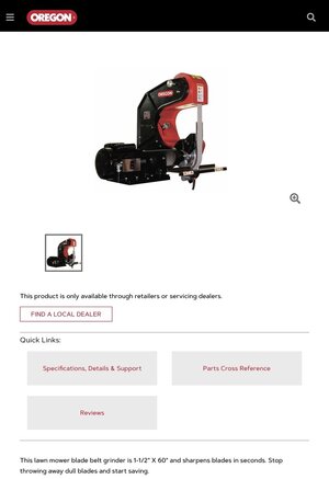

This is my preferred tool for sharpening blades…
We got one about 10 yr ago, and it has paid itself off many times over.IMG_0939.jpeg
