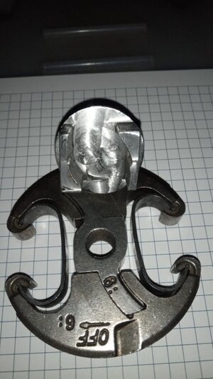

Hopefully you two versions of this Poulan clutch tool. One has the pins slightly farther apart which why I had order the second one.
11:16 PM
15,001
59,855
It is a Husqvarna 36 or something like that clutch tool.
I made that one just because, I have no use for it and I wasn't asked to make it.
I had to buy Husqvarna clutches to make the tools and the eBay seller had that one too so I got it as well.
The Husqvarna 353 tool was a request.
Aparently the OEM tool is made out of sunray hardened bubblegum, or so I'm told.
530031112 fits Husqvarna 136, 141, 36, 41 and Poulan 2035, 2775, 4016, 4218. And own a 4218 with the NCC cylinder.
530021116 fits Craftsman 2700, 2800 3000, 3000CB, 3100, 3300, 3350, 3450, 3500, 3600, Poulan Pro PP285, PP305, PP330, PP335, PP336, PP336C, PP365, PP365C, PP5020AV, 1975LE, 2025, 2050, 2050LE, 2050WT, 2055.
Since I work nearly every one of these saws it was necessary to have in the clutch tool bin.
The last image is a tool I use here and never had a problem other than a tight fit that to tap on at times. and that one is the
  • 546372801 Replaces: 502541603, 502541602
  • Fits Husqvarna: 42, 242, 246, 340, 345, 346XP, 346XP, 350, 351, 353, 435, 440, 445, 450, 455 Rancher, 460, Rancher 461
  • Jonsered 2141-2153

Most screnches are just preased round seamed tubing, soft.
A socket is a better workpiece choice.
I chose and really like the properties of high tensile ISO12.9 grade bolts as raw stock.
Very nice custom tools! No surprise 🙂
I like the chains in the original post for use on pole saws: they don’t bounce on small diameter limbs.
Apparently, that’s why they were originally developed: the reduced kick-back performance was discovered as an unexpected result.
Not necessarily the best choice for large timber.
Re: cheap screnches, that design is actually protective.
Working on someone else’s MS250, I turned a genuine, STIHL scrench into a spiral trying to loosen the bar nuts. Like a soft noodle!
Heard of that, but never ‘believed’ it!
Guy had misplaced his scrench and used a ratchet and socket. Easy to apply more torque with those, and easy to strip out the studs from the plastic case (most guys don’t carry a torque wrench in the field).
But I hate when clutch removal tools slip!
