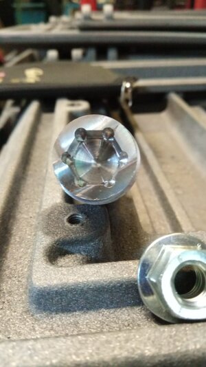

Okay here is one for you guys. I brought two replacement anvils for my Woodland Pro Rivet Spinner. Right of the package one would fit and other one didn't. Both looked identical. I have resolved the problem but what could cause the problem? And it was not burrs from dinging around. And flats calipered the same spec.
I would like to see your guesses.
You’re saying it wouldn’t fit inside the hex?

The corners weren't knocked down sufficiently on the one that didn't fit.
As such measured flat-2-flat One would get the same dimensions, but not when measured corner-2-corner.

Damn, those could be made out of CR-V allen wrenches.
What do they measure foat to flat?
I think mine don't look like that, Oregon spinner.

Wilhelm, You won the Quippy doll. When weren't knock down they measured .002+. I don't remember the flat dimension right now
BTW the Anvil picture is for an Oregon Rivet Spinner. The Woodland Pro looks like this.
And they are not interchangeable per Baileys as I asked them about that.

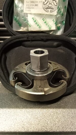

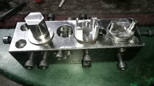

Yeah, I encountered that milled allen to hex socket fitment issue making my clutch removal tools (they aparently did not fit SnapOn sockets).
I since added a circular milling path to all programs to knock down the corners after the hexagon is milled.

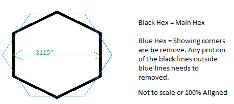

See actually experience does help sometime. It is like something you ran into years ago may not happen for years then suddenly pop up working a completely different equipment. I have had it to happen to me as I traded trade fields due necessity. I was over qualified when I was layoff and no would hire me so I had to find a new line of work.
Wilhelm, just got to shop the flats are .3115. Of you divide by 2 for centering.
As you found nearly all tools and hardware has there radius at the edge of the hexes or any other tool that has corners. It probably has to do the way casting works.
Basically on the tool here they did a double hex with the larger one for knocking off the sharp corners but rounding works too.
Now for as the Span-On tools they probably removed sharp edge or open up the corners so the tool drives on the flats (flank drive) instead of the corners. This would help to stop the rounding of corners when removing struck fasteners.

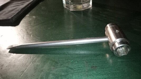

Making my custom 13mm screnches I had no choice but to dig into the corners of the socket hex considering rounding off bar nuts on 30ish chainsaws and any spare stashed nuts was never an option.
The scrench socket being made out of ISO12.9 grade bolt steel and not being used with a power tool but by leverage/hand I had no concerns about durability.
It is my go to scrench since I made it.
While making my clutch removal tools I was obsessed with fitment, toughness and durability since they were meant to be used with an impact drive.
I test fitted their hex side into every socket I have, still once they came to prooving grounds in the US I was told they were oversized for SnapOn sockets.
I tracked the issue down to having left the milled hex sharp cornered, merely debured with a flat file.
On consequent makes I added a circular milling path to knock down the hex corners.

Tried this tool with a scrench but failed as things just went sideways so I had impact socket done. Beside I can now use a pull bar for extra leverage.
Most screnches are just preased round seamed tubing, soft.
A socket is a better workpiece choice.
I chose and really like the properties of high tensile ISO12.9 grade bolts as raw stock.
